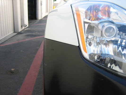

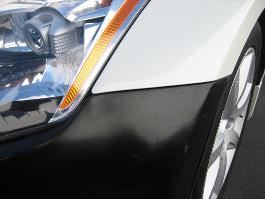

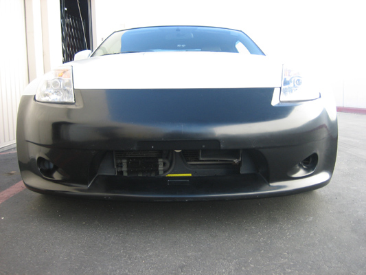

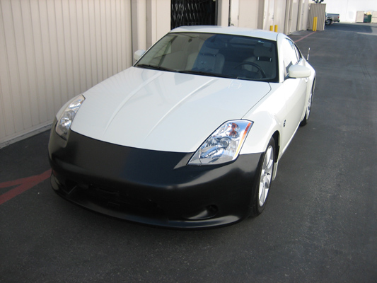

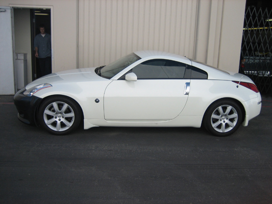

Hi guys, i did my test fit lastnight. It fit great, here are some pictures of it. There is a little prep work todo but thats to be expected. These bumbers are made with the hand-laid fiberglass mats. I can take a picture of that if anyone would like to see. I am very please with it so far. Next step is to prep it, then have the body shop prime and paint.
I found this information on "Rods & Customs" web site
"Look for a body that’s made of hand-laid fiberglass. That means fiberglass mats were laid on top of the gelcoat in the molds, which ensures uniform panel thickness no matter which way the panels bend or crease. If the fiberglass was shot onto the gelcoat using a chopper gun, there’s no guarantee of uniformity, especially in the curves and corners. (Chopper guns are best used for broad, flat surfaces, like boat hulls.) It’s also harder to maintain a uniform amount of resin when using a chopper gun, and too much resin in the fiberglass makes the panels brittle."

fitment looks great,hopefully this convinces more people.
thanks for the post.

Looking good!
