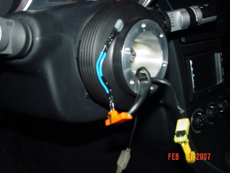

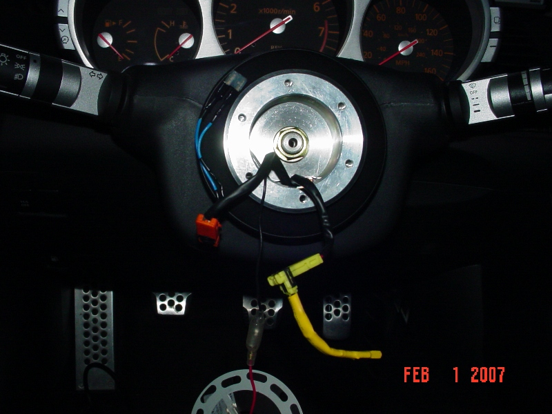

After seeing the pictures, I now remember what I did. You will need a seperate resistor for each connector. When I get home, I will take the hub off and snap some pictures, if needed. In total only 2 resistors are needed.
AHH> ok. that seems about right..
prolly 2ohm each.?

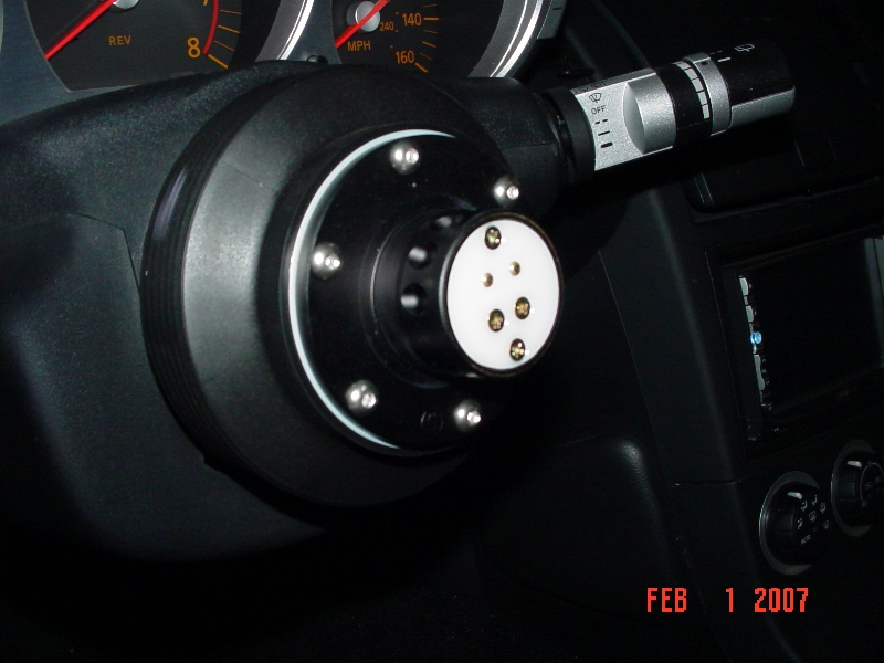

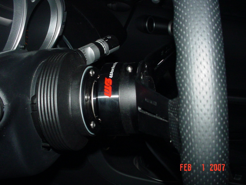

No, I am using the Works Bell hub. Here are a few pictures that should clear some things up. As for why it won't turn, I have no clue.

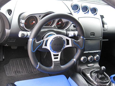

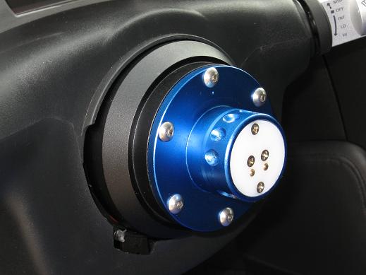

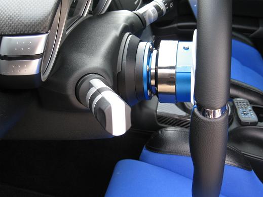

This is what my set up looks like,,,

Damn, I can't read! He has a Momo wheel with the Works Bell hub and quick release. I have a Nardi wheel with the Works Bell hub and quick release.
Yes, you can spin the wheel until it locks.
As far as the knock off, I am not sure. If you get a quick release, make sure you get the short hub. Otherwise, the wheel will be too close for comfort.

Momo Trek! {black}

That blue hub is hooootttt!!!
