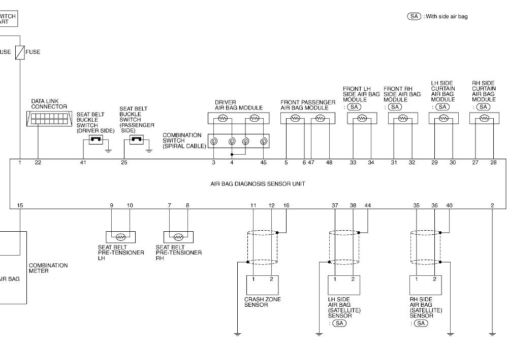

after lookin at the service manual, the driver side airbag has 4 connections (as compared to the side seat airbag which only has two.) then goes to three from the spiral conenctor. did you put the resistor between both of them? i.e. connect the red with the yellow with a resistor in the middle?
i think you'll need two resistors for each connector..? just whatever you do. DO NOT PUT MULTIMETER TO YOUR AIRBAG to try to measure the resistance.. the voltage inside might set it off..

After seeing the pictures, I now remember what I did. You will need a seperate resistor for each connector. When I get home, I will take the hub off and snap some pictures, if needed. In total only 2 resistors are needed.
