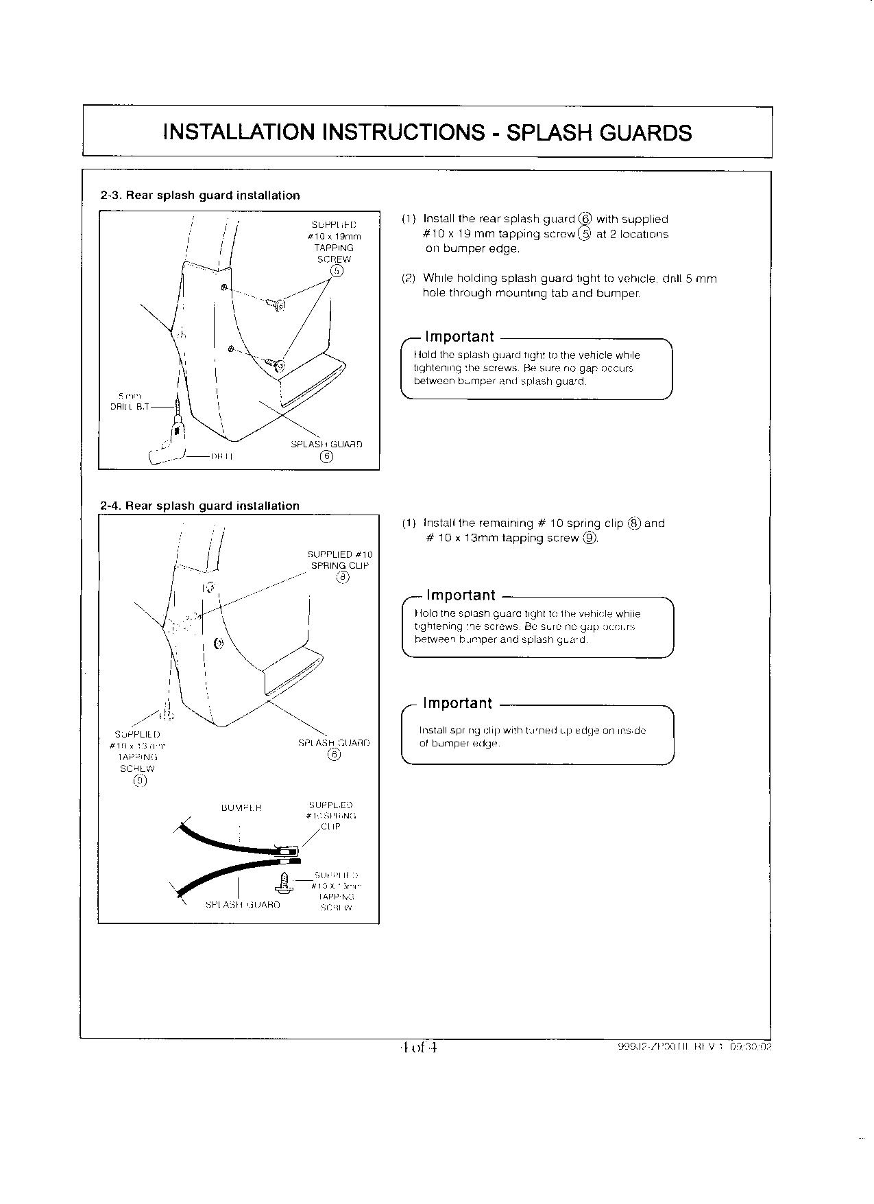

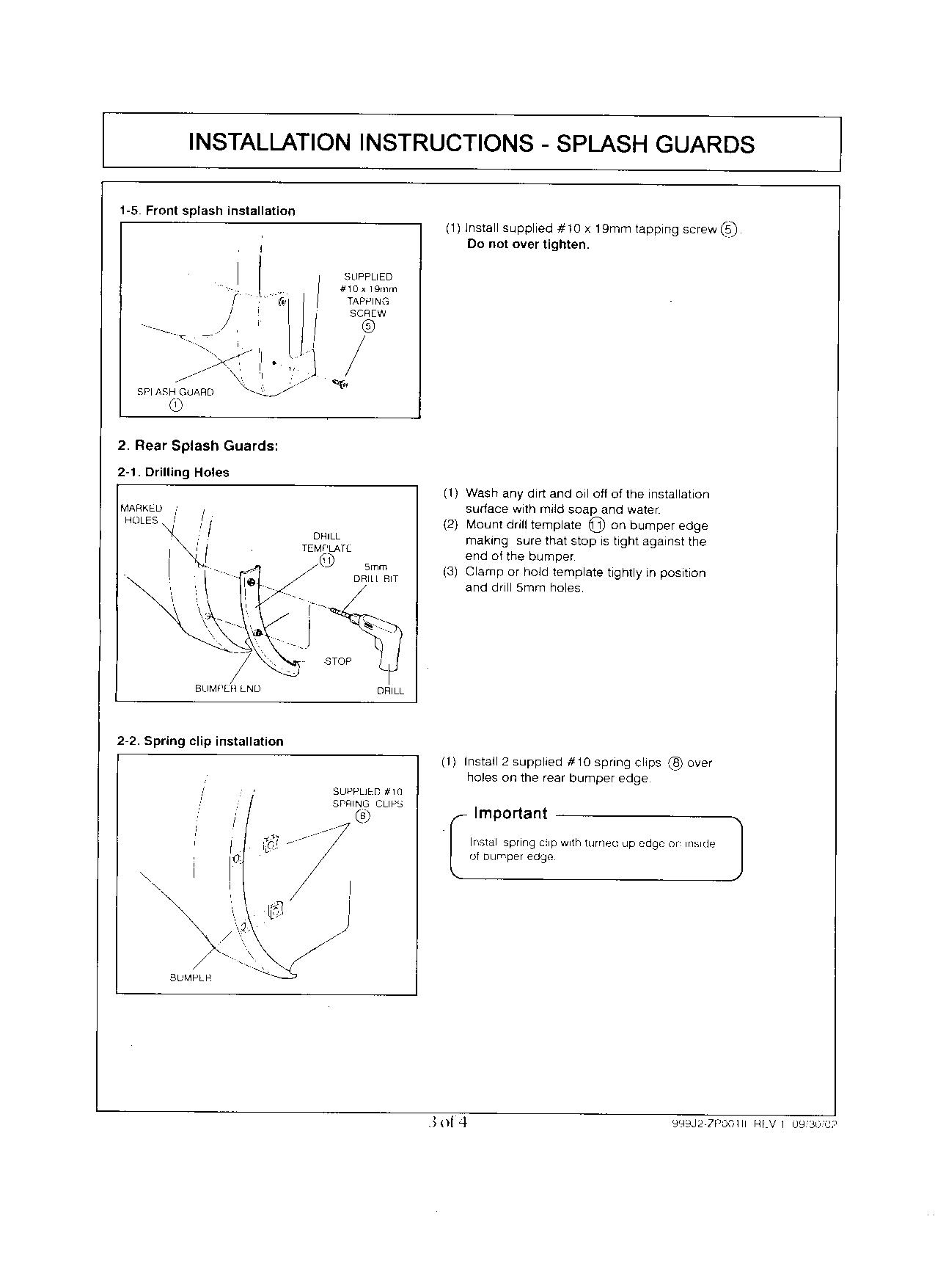

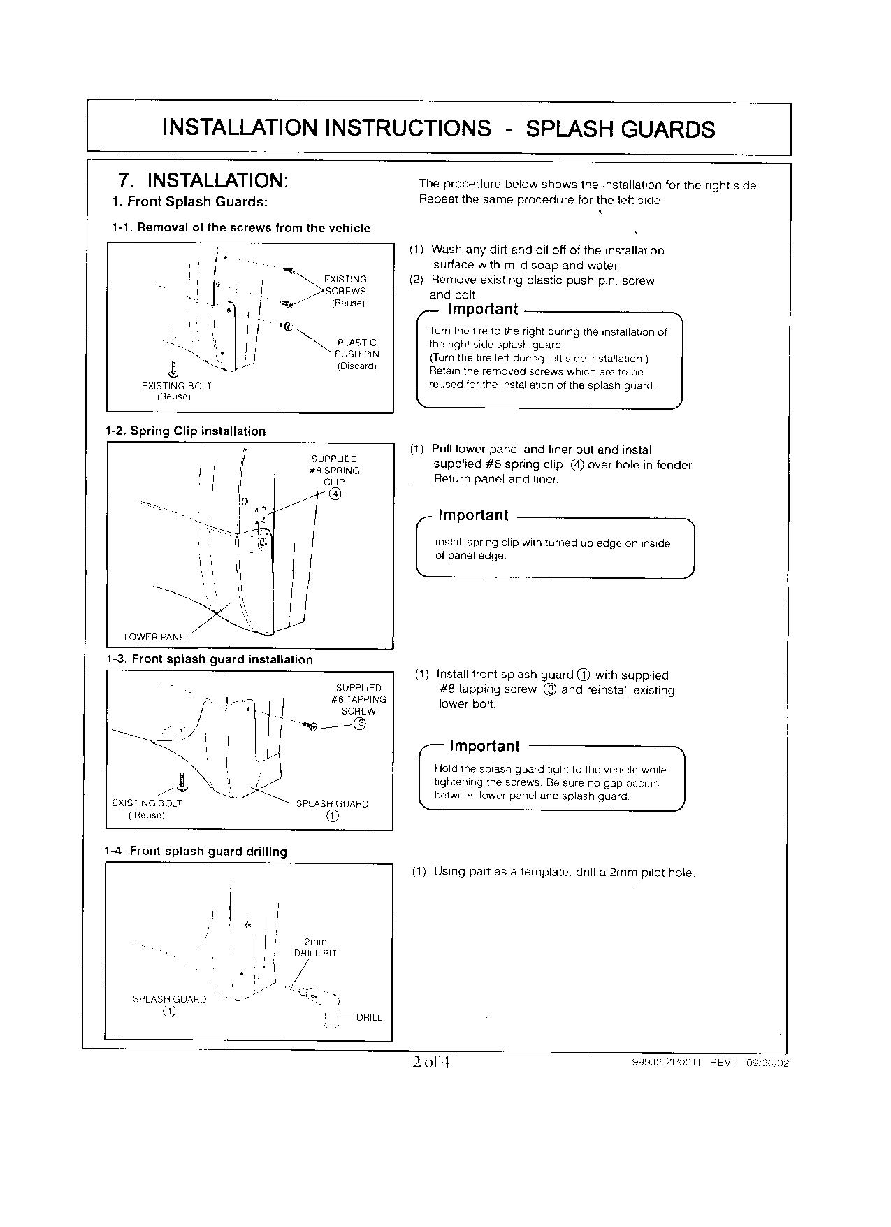

Sorry no help on where to get, but here's the original fitting instructions....
Attached Thumbnails Hardware for slpashguards?-picture.jpg   Hardware for slpashguards?-picture-001.jpg   Hardware for slpashguards?-picture-002.jpg
