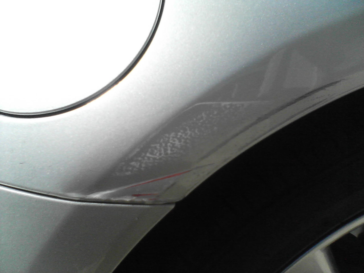

hey guys I have a problem. Someone hit my car on my passenger side rear fender and it looks like crap now. I have to replace my rear fender but no one answered my question on the regional section so I will ask this here. Is there any place that sells replacement rear fenders for the 2006 model? I am probably gonna get a body kit JP Type N or Vertex but none of those are widebody so they won't cover up the fender so I have to replace it anyways I would think. Another question is, is the fender on w/ a couple of bolts and screws or is it on there by something else like clips? I never done body work so I don't have a clue especially on the rear fender. The last question is...should I just take it to a body shop and get it repaired would that be cheaper. I am a college student so I need the method that is the cheapest. Any help would be greatly appriciated. Here is what the damage look like.

That would be a quarter panel. Just have it repaired. It's welded in.

Dude I do autobody work for a living and theres no way anyone would replace that,that damage is very very minor,just go to a couple different shops ang get some price quotes or claim it through insurance

I had something VERY smiliar on my SE-R... bodyshop should deffinetely do it.. I got mine fixed and repainted for $225... and looks like it never happend

There is no replacement for that.............. Just get it repaired by a body shop!!

There are replacement quarter panels, its just more work than necessary for this much damage. I can assure you if a qp is smashed in they will replace it rather than pull and straighten it

ok thanks for the help guys. =) I thought it was just on there w/ a couple of bolts but nvm. I guess thats why I haven't been able to find any replacement for it XD. As I said I never did any body work so. I guess I will get that fixed while I get the dents fixed also. Thanks once again guys.
