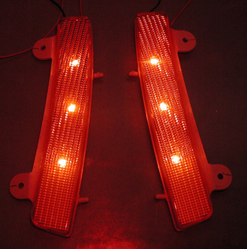

my search here kept coming up with these ones, but they are also the most $$$$! really worth the $85 they are selling them for? the quality and build that good?

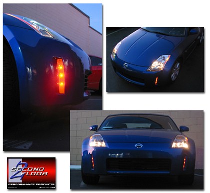

The LEDs are epoxy'd into holes drilled in the back. They have a life of 200,000 hours, so I don't expect to ever need to change one, but still could. All wires and resistors are soldered and heat shrinked. I then Black RTV everything to make it water tight and to prevent light leakage.

I just made my own, easy enough, LEDs are not real sensitive to moisture, but just the same, you drill holes in the back, then put grommets for them to sit in, which you actually glue the LEDs to. I then basicly topped of the back of the grommet and led with super glue, which sealed it up good and tight, and soldered the leads directly to each other. took about 30minutes to make them, and I did it at the kitchen counter with a bottle of super glue, drill with 1 bit, and a grinding wheel, and soldering supplies.
I was going to make another from the stock reflector with 14 LEDs in each reflector(a website sells them, for 200$!!!) but the LEDs alone are like 20$, so I just havent gotten around to getting them.
