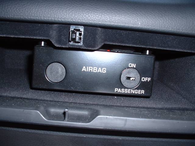

OK, I'll see if I can clear some of this up. I tried to find the
Nissan directions so I could scan them, but I was unable to
find them. I took two pictures to show the switch box
and the indicator light location that I choose.

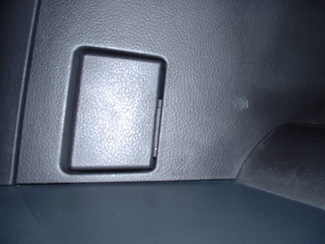

I choose to go from the fuse block straight across the dash
and mount the indicator under the cup holder. It is hidden
completely out of sight except for a small hole for the light
to shine through. The switch and everything else when in
the suggested locations.
You can see the small circle under the cup holder which is the
indicator light. The picture is taken sideways. The top of the
dash is towards the left.
Hopefully the pictures will help...

Here is the second picture. Sorry I couldn't show you the
ugly box in all its glory, but I'm not taking the dash apart
again! Just think of a black box 1"x1.25"x1.75" with a
plug out the back and a hole drilled through the center of
your map light cover which is visible from any seat. My way
is MUCH LESS noticable!!!

See my detailed description of Sensible Solutions' (airbagonoff.com) installation of two switches in my car here. I chose to have them installed in my (empty) nav compartment, but you could place them almost anywhere else.
My only regret is the switches cannot be flush mounted, so I couldn't go with my original plan of placing them in the center console where the seat heater switches are mounted in the touring model.
Otherwise I am very happy with the hardware and the installation.
