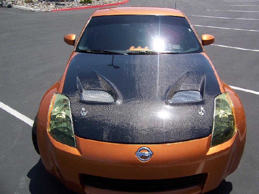

I am using the sparco pins. Easy to install and look good.
Attached Thumbnails Which hood pins to buy for Seibon CF Hood?-100_1289aa.jpg
