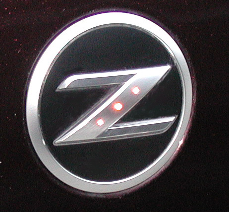

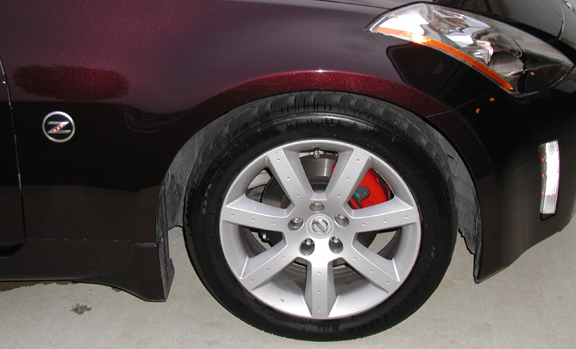

I pulled off the front Z badges from the side of my 350 and installed three LEDs in the squares.
These LEDs are 1.6mm x 0.8mm so I have to use a magnifying glass to solder the wires and resistors to them. Its hard to believe they are 1300 mcd's each. To the human eye they are as bright as the ones I and others have been putting in the side markers. Stare at them and you will be seeing three dots for a while....
I'm on my second set of LEDs and it looks like I have a viable assembly process. The first set took 4 hours to make and have been on my car for two weeks. They have survived two rain storms and two car washes so I believe they are water tight.
Before I start selling them on Ebay, I thought I would try some feedback from the forum. I hooked mine to the turn signals. I have the Clear side markers with three amber LEDs hooked up to the parking lights.
What do you think?

Its tough to get a good picture with a digital camera. Trying to catch them when they are on is a pain....

so what did you do? Take off the side emblem, drill tiny holes in the 3 dots and then put in the ultra tiny high intensity led's?

looks good man. 3mm LEDs? or smaller?

How did you ensure that the assembly is watertight?

The LEDs are half the size of 3mm. 3mm were too big.
I don't recommend trying this unless you have several years experience with a pencil tip soldering iron and a very steady hand. I wasted a dozen LEDs trying to get the right set up and methodology on my first set. The second set used a different style of LED, same size and intensity, that dropped the assembly time to a couple of hours.
The LEDs are glued into the holes and the back side is covered with silicone.
