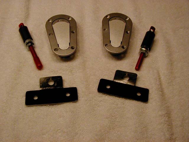

Made Brackets to adjust for hood & Pin Angles ..
Attached Thumbnails My Aerocatch Hoodpin installation-aerocatch-brackets1.jpg

Looks good. I can almost gurantee if I tried to install that style pin, I would end up ruining the hood.

agentman03, rx7/350z.........we need install pics!
willing to make another set of those brackets?

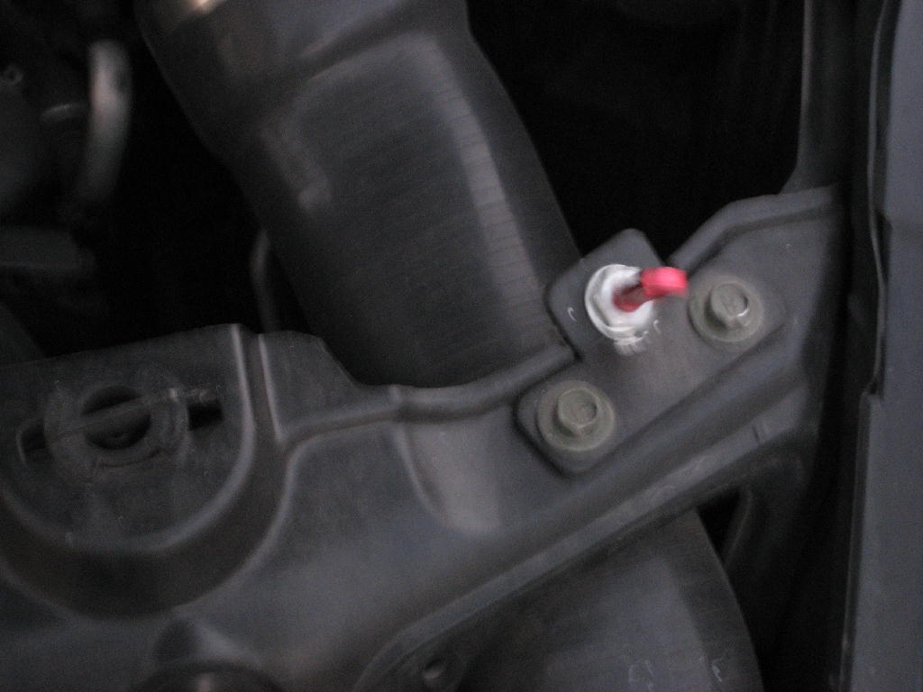

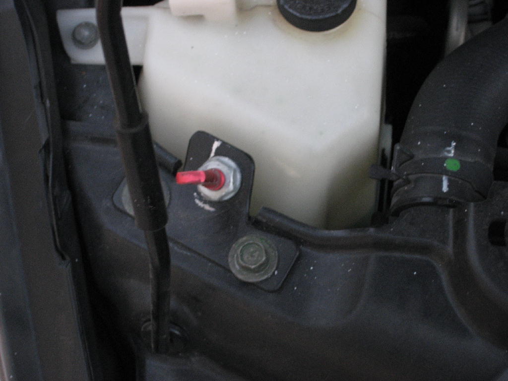

Default Aerocatch brackets
Wont get to my install till this weekeng , but attaching pictures similar to the brakets that I Made ...
Attached Thumbnails My Aerocatch Hoodpin installation-img_0041.jpg   My Aerocatch Hoodpin installation-img_0042.jpg
+1
I'd be interested in a set of brackets as well....

I'm installing this Aerocatch latch right now and ran into that same issue of having to bent the pin of have to use a bracket to tilt the pin to fit. After looking at the location. If I place the latch slanted toward the head lights then it might works. But I placed them straight up Now I'm stuck.
Haha that looks like my bracket... And my pics. Lol. So far bracket still holds and latching the aerocatch is easier.
