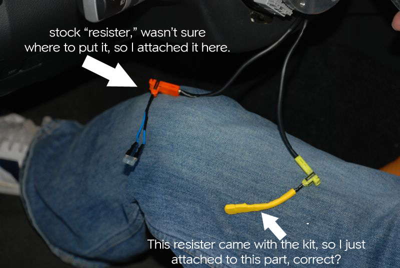

This is the pic I was looking for, where it looks like the 2 clips/wires of the resistor just plug into the yellow clip.
Now why he has a resistor on the horn plug, I have no idea.

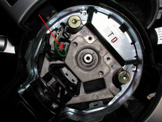

Ok now i think i mostly got it now.
That gray plug with the black wire with the kit, must replace the factory plug and is a general ground of some sort. It replaces the factory plug that is in this picture and is ground to the same metal tab thing a ma bob like the green wire is.
If there is only one wire that comes out of the 7 pin kit plug, the only reason i could see replacing the factory plug, would be if you have Cruise control, which would have more wires coming out of the 7 pin factory clip.
It's the same function as the green (ground) wire because it's located in the 3rd pin position like the factory green wire which isn't actually green because in that pic it's from a G not a Z.
