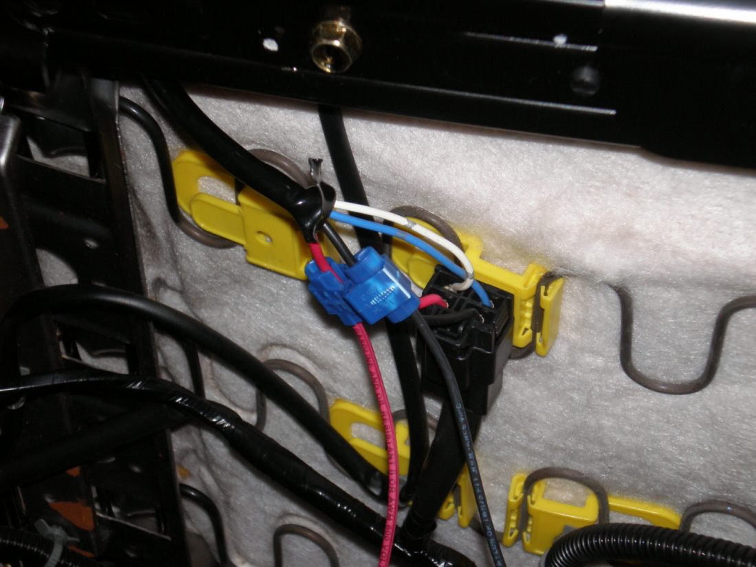

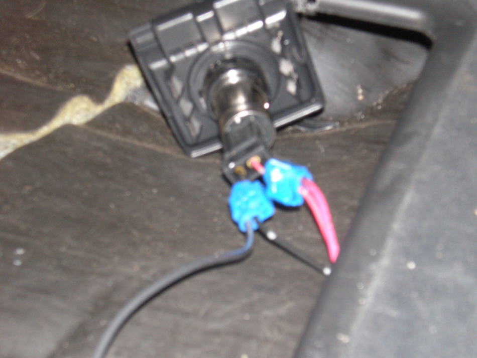

Hello everyone. Just thought I'd make a DIY.
EDIT: Hey got these seats to work!!! It was really easy just takes a long time! Here are some pics of the install. Just connect a few wires and it works!!!!
1. Remove seats
2. Remove shift ****
3. Then AC unit
4. Then Center Console (between seats) 4 screws
5. Remove trim piece near where bottom of the door closes (then other side)
6. Remove side panel under small side window
7. Remove other side
8. Remove entire back panel (where rear glove box is/power outlet)
9. Pop out power outlet for easy access
10. Run wires under carpet and make a whole near plug under the seat for a clean look!!!!!!
11. Connect wires as shown in pics. NO CUTTING NECESSARY
12 Power outlet should have four wires attached when done. (Pic was taken only after one seat was done)
BAM power seats in a base/enthusiast with out paying a ton for it

I think we need to run two wires. One from cigarette lighter (power) to the seat. Not sure what wire is power to the motor of the seat. Then one more wire from ground to the ground wire coming from the seats motor!! Can anyone tell me what wires these are coming out of the bottom of the seat??
Old Feb 21, 2008 | 03:06 PM
Eazzy's Avatar
Eazzy
Joined: Jan 2005
Posts: 8,268
Likes: 6
From: Barackville
What specifically do you want to know ----As far as Power seat movement, The drivers side has 4 mains (G) Green and (OR) Orange for the recline and (Y) Yellow and (SB) Sky Blue for the Slide.
The Pass has only (Y) and (SB) for slide
There will be a Black for a ground
Old Feb 21, 2008 | 09:04 PM
labelworkshop75's Avatar
labelworkshop75
Posts: 739
From: Orlando
So if I want to move in all four directions I need to run 4 wires to power and 1 to ground for the DRIVER seat. And 2 wires to power and 1 to ground for the PASSENGER seat?? seems like I'm almost ready to do this install

This is your answer. You only need a power and a ground. You're making it more complicated than it is. Look at Dave's wiring and copy it. I don't believe I saw any extra wiring when I took out my seats to do this install... All there was, was the seatbelt clip. Maybe what your Eazzy is talking about is for airbags?
Old Mar 1, 2008 | 10:36 AM
labelworkshop75
Posts: 739
From: Orlando
Yea I FINALLY GOT IT TO WORK! It was a huge pain but a fairly easy job. Just tap into power from the rear power outlet and run 4 wires, 2 to each seat and splice then into the cord shown in the link above. The hard part was stripping my car down to nothing so I could get to the power and run the wires nicely!
