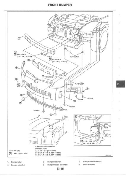

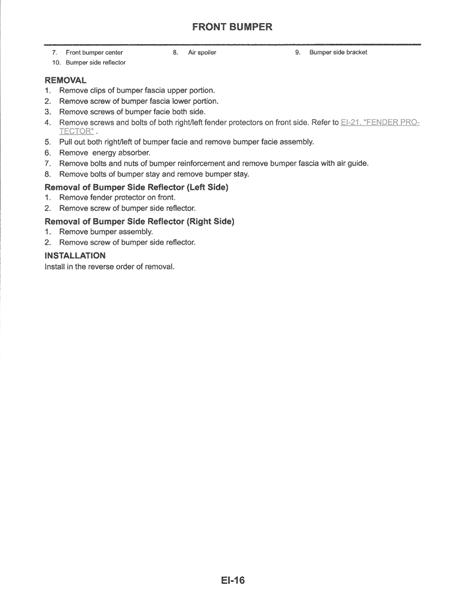

I'll try to get a copy of the service manual page showing all the bits and post that, as well.

Here you go. By the way, this seems to indicate only two screws attaching the bumper to the fender but I am pretty sure there are also two bolts. Either way, it's easy to get the thing off.
