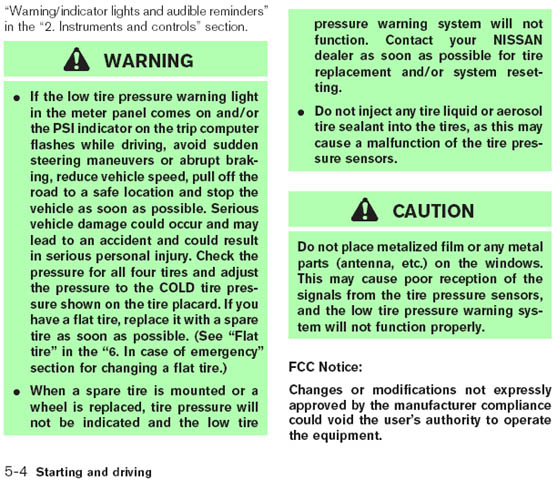

Metal based tints aren't recommended if you have the tire pressure sensors, btw.

I didn't know that, I'm glad that I dont have the tire pressure sensor then . I do know that metal based tint can affect your laser/radar detector and interior intrustion alarm if u have one. Although my radar detector seems to be working fine still, I will probably invest in a valentine soon so that the sensors can be outside the car.

I knew I'd read it somewhere, it is in the manual:
Attached Thumbnails Is it ok to tint if you have the "grease streak"?-tiregaugetint.jpg
