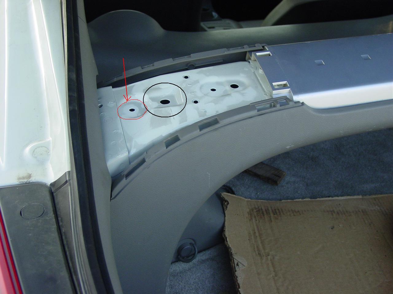

i found that squeezing the ends and making it bow out a little helps pull them out with out breaking the tabs...
I take them off every now and then for adjusting my suspension.
I'm planning on finding a really long allen key and drilling a hole in the plastic and leaving the allen key sticking out.
- j
Attached Thumbnails How to take apart rear strut tower plastic panels?-dsc02852.jpg   How to take apart rear strut tower plastic panels?-dsc02851.jpg
