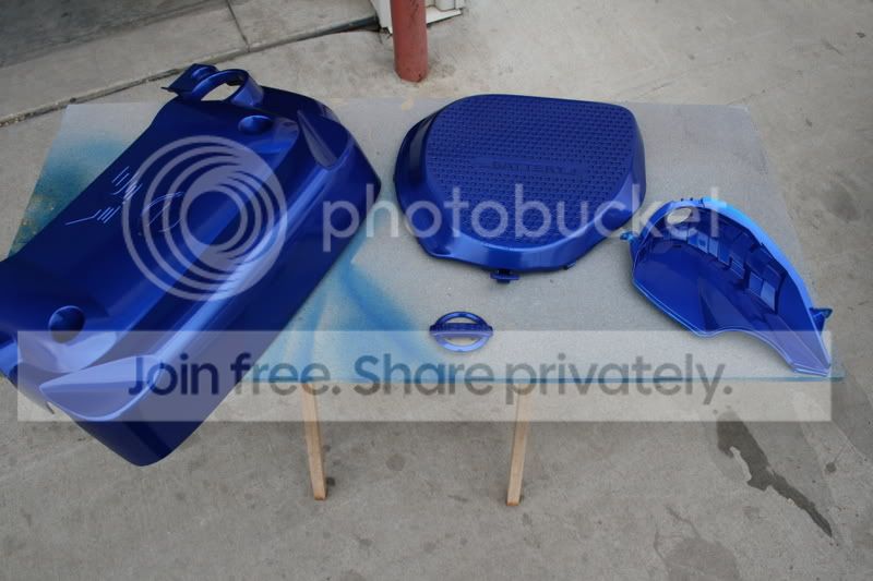

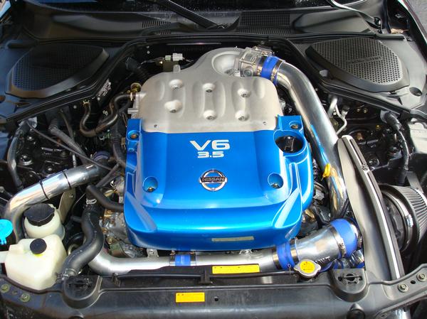

Well i just used a scuff pad and some prep cleaner for plastic then sprayed it with crome about six times then with a blue anadized color then a bunch of times with high temp clear. It gave it a candy blue color and it changes shades depending on how you look at it. the picture does not do it justice.

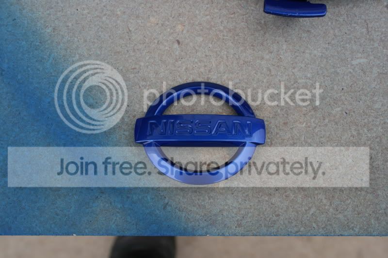

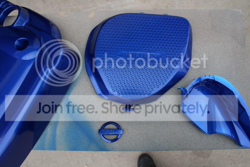

Did these for "APSTTRDSTR" (Member here). I only use Dupont paint and clear. Never rattle can any of my stuff.

^ your paint looks sweet, except painting the NiSSan hamburger
That looks sweet.
