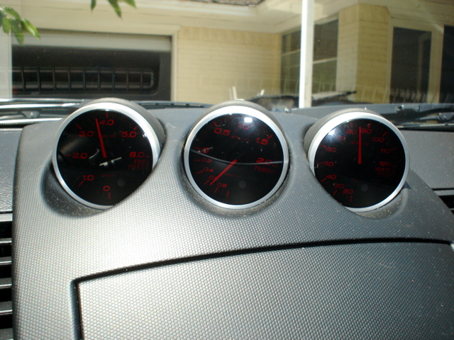

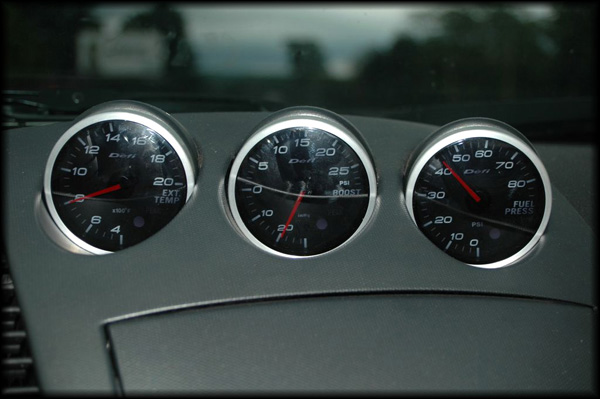

Sorry I don't have DIY pics of installation, but here's a few Defi setups:
Attached Thumbnails Defi Gauges-defibfgaugeson-1-.jpg   Defi Gauges-dsc_0001_001_001-1-.jpg   Defi Gauges-p1010640-1-.jpeg   Defi Gauges-p1040038-1-.jpeg
Old Sep 2, 2008 | 11:53 AM
vinnycuz's Avatar
vinnycuz
Posts: 172
From: Howard Beach, NY
Thank you, they are all 60mm gauges?
Old Sep 2, 2008 | 11:59 AM
gothchick's Avatar
gothchick
Posts: 3,300
From: ATL
Yep.
