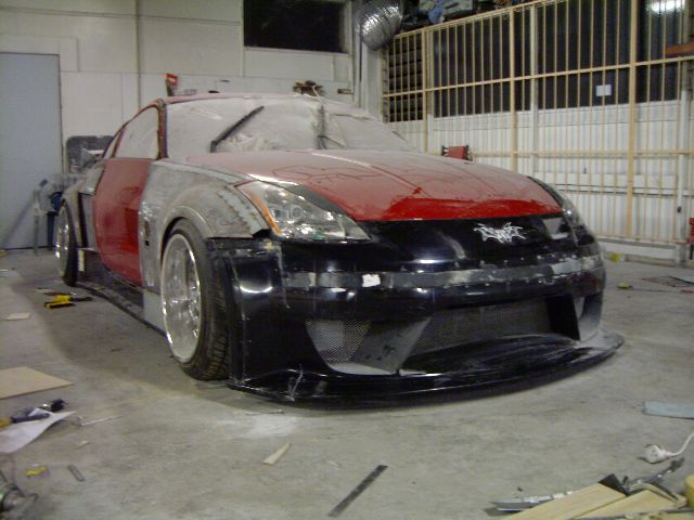

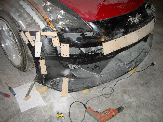

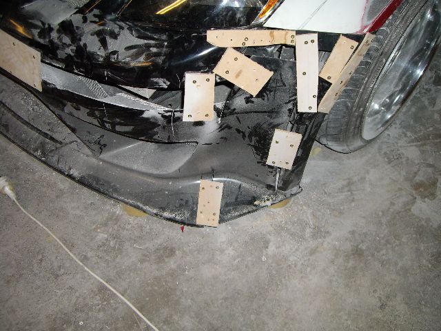

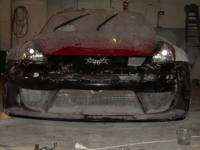

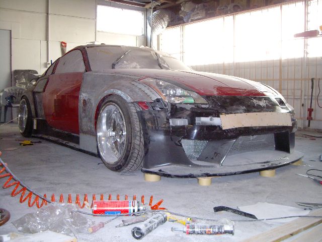

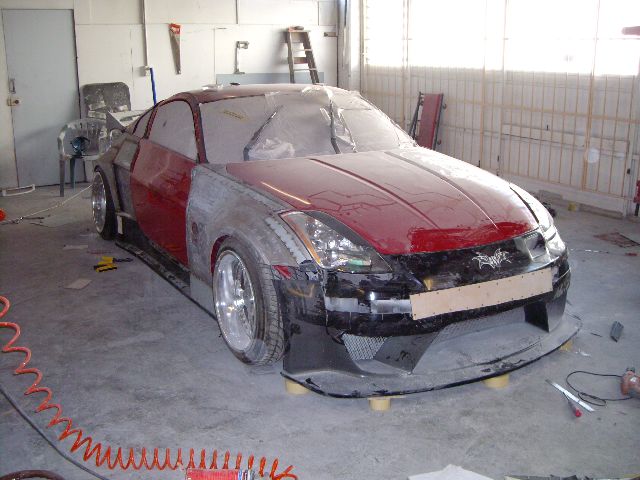

hey guys been a while!! started working on the car fully now, i actually only have 10 days left to finish it now before the show.
there will be alot of all nighters coming up as you can imagine!
the front kit i found was just over 2 inches higher than the skirts so have started chopping that up and placing where it needs to be so i can glass it back together.
there is still alot of work to go as you can prob see!
well heres some pics

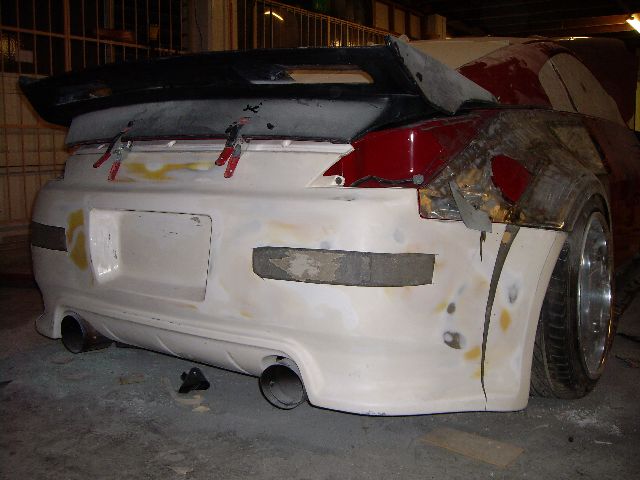

one question to the OP first off i wanna say again that this is VERY nice work! but only one concern hope u didnt weld his gas cap shut as it looks like u did in pic 3 on post 25 lol! again awesome work!
Old Jan 11, 2009 | 11:18 PM
gt refinishers's Avatar
gt refinishers
Joined: Oct 2008
Posts: 47
From: new zealand!
haha na they plastic cap!
it has been trimmed up to where you can see it though and the panels are fully welded behind.
still works as factory, we were origionally using a harly filler cap (in a sparco style) but it worked with a reverse thread and i couldnt find any filler pipe to suit and couldnt find a tank in time to chop one off!
looks a little weird in the pic as its a diff colour its sorta a 3/4 moon shape now.

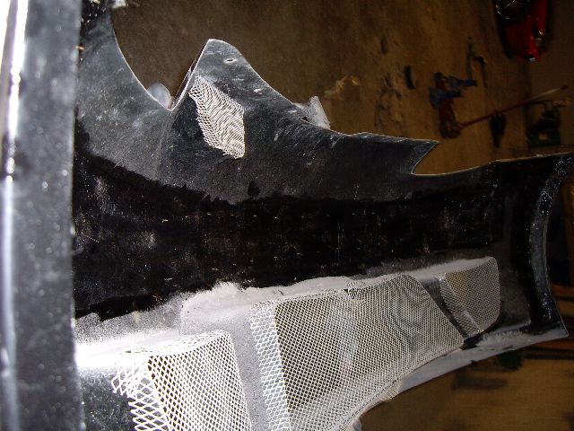

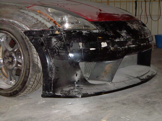

so the front was 55mm to high and didnt match the skirts and i had to chop the length of the kit so i could make it the right height
also i had to widen the sides to match to the guards.
looks like a mess at the mo but will post pics as i go over the next week and a half!
3rd pic is of the inside re glassed where i have set the bumper at!
4th pic a shot from the rear!

WOW, great job! Looks aggressive as hell! Keep up the good work...i just wonder how good the bumper will look extended like that...hmm

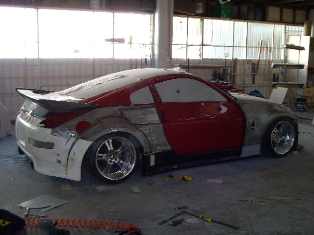

heres some of it back on with just the back glassed up.
(all the wood ect removed)
i know its hard too see and the car is very very low but what you guys reckon>?? can you tell much of a difference?

nice work man. I'd personally wouldn't do wide body out of fiberglass and think its pretty cool you use steel. And the JP type n front bumper is made uneven from the side skirts. Kind of bothered me at first too, but not enough to pay someone to chop it. looks like its gonna be sick when its done!
