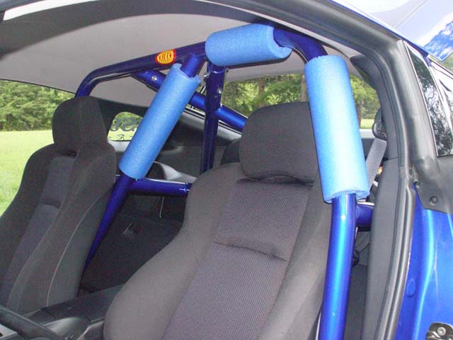

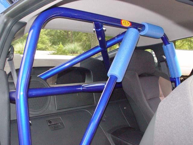

i had this bar made by kirk racing. they will be selling the four point bar for around 325 and you can have the rear diagonals ran differently but with the rear bars in the x pattern you have full seat reclinability, and yes my seat slides all the way back. all of the storage bins open with no problem. i am 6'3" and 250lbs and do not even notice the bar is in their even with a helmet on but the passinger will, they lose about 5" of seat travel. they do offer a full cage also. kirk racing 1-205-608-1156
btw we are running vir sept. 20-21 so come check out the bars. we will have two 350's with bars in them thanks.

the car feels alot more solid but i did not drive it long with just the bar in, i installed s-tunes and cusco's sway's two days after the bar went in. i have about 3.5" from the padding on my bar from my head with out a helmet on and the bar is only about 2" above my head. i will try to get more pics sometime my camera got droped and the pics are pretty fuzzy now.

i would have to take the seats and carpet back out and that ain't going to happen. it mounts right up aginst the rear bins. if you reach behind your seat and push down the carpet you can feel a low area about 3" wide and 8" long, thats where it mounts. you can call kirk racing, i belive they took alot of pics when making the bar. and it only takes about two hours to install.

the bar is scca legal thats why i got it ( for solo 1 ). and the bar comes in flat or gloss black. i had mine painted at a local body shop while i was down in alabama getting the bar made.
