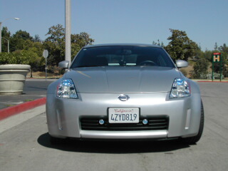

here's a pic
Old Sep 12, 2003 | 05:37 PM
toothlessracer's Avatar
toothlessracer
Posts: 127
From: LA, California
here's a pic
Old Sep 12, 2003 | 06:16 PM
AndyB's Avatar
AndyB
Posts: 1,389
From: Connecticut
Default nice
Originally posted by toothlessracer
here's a pic
Nice! They look almost like FANGS in the grill.
Did you have to trim the horizontal grill pieces to make clearance?
AndyB

I had to cut 2 of the grill lines ( i was hoping it would only be one) the lights were about 1/2 too tall to fit while only cutting one grill line.
if you have a sound system it's a pain in the butt to run the remote wire for the lights in the cabin. I'm using 4 gauge power wire for the sound system.and it was a pain in the A$$ to run the wire throught the firewall. PIAA comes with a "quick disconnect" along the power wire. which has to go through the fire wall if it doesn't you wont be able to reach your "on off" switch.
I'll post close up pics tomorrow.

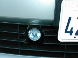

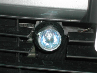

if you look inside your engine bay where the injen intake goes there is an aluminum bumper. I drilled two holds on the bottom of it to mount the lights.

my lights are flush with the rest of the grill lines. the bumper is thick enough that you can have the lights be behind the grill lines so you dont have to cut them. However if they are of high wattage they can get hot and melt the plastic.

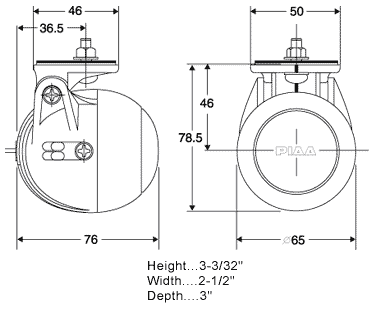

Default PIA 110X Dimensions
In case anyone besides me cares this is a
picture of the 1100X lights with dimensions.
File Type: bmp
