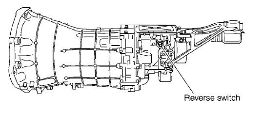

Does anyone know where how to get to the reverse switch on the transmission?

while in reverse you should have continuity, every other gear, nothing.
did you check the back harness? or the back up lamp relay? E19 harness in the fuse box by the battery..
the reverse switch on the transmission:
Attached Thumbnails Help! Reverse/Backup Light Problems-reverseswitch.jpg

Yep checked the harness, seems fine. Only get voltage with reverse engaged, out of reverse, nothing. (manual shift).
Dont' think uk spec cars have a relay, unless its in the IPDM behind the battery. Thats my next thing to check I think..
