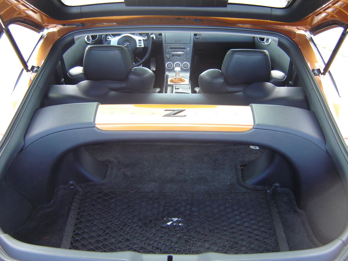

Here's how mine turned out, it's kinda a bad angle.
