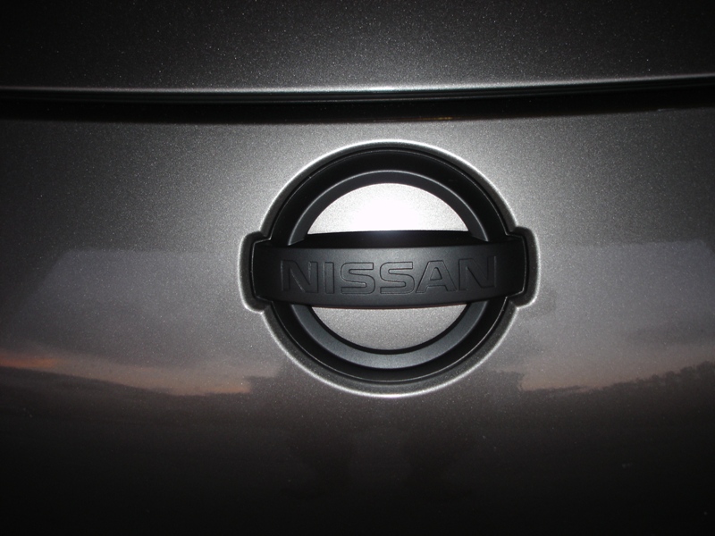

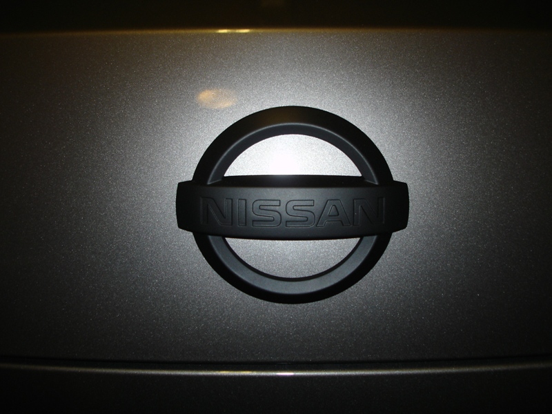

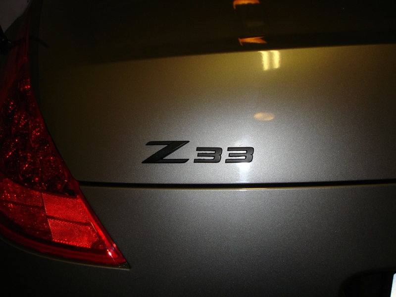

the 2 pins only protrude from the rear of the emblem simply to only properly align the emblem when putting it on. they only stick out about a 1/4 inch or so.
when taking the emblem off you can use fishing line or what i did was take a heavy duty thick leather glove and put up against the car and take a small flat head screw driver and prop it under the lip of the emblem but resting on the glove to ensure i didnt touch the paint with the screwdriver.
thats how i did it and dont have any scratches dents or anything wrong with my paint or emblems. i did it the same way to the front

BlueZ33, u're ahead of me..!!!! i was gonna do the same! black out the burger, and debadge 350z and just keep it as Z33.!!
uhh..!
looks nice btw!
