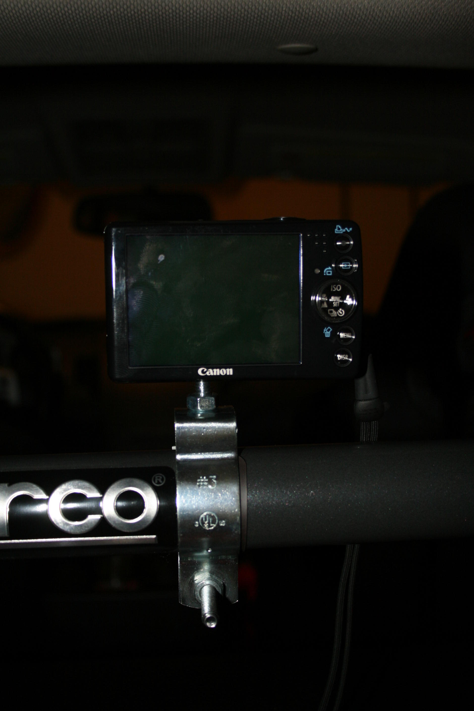

I just went to lowes and got a 1 1/2" conduit hanger and a nut and bolt that fit the cameras i wanted to use and clamped it all around my harness bar and it works like a charm best dollar I have ever spent

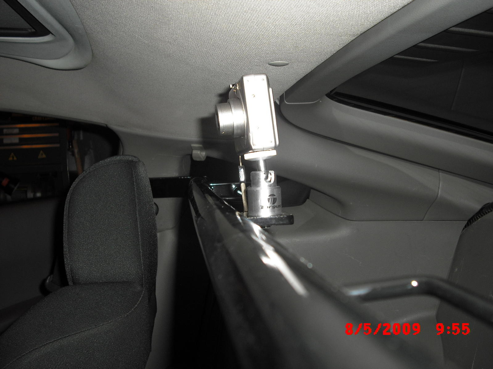

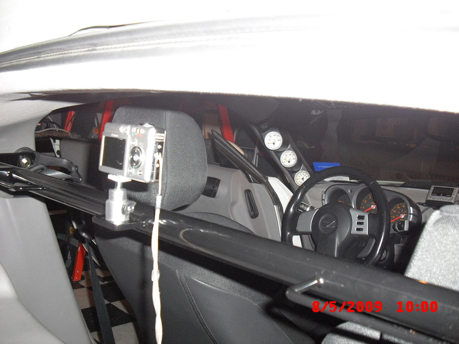

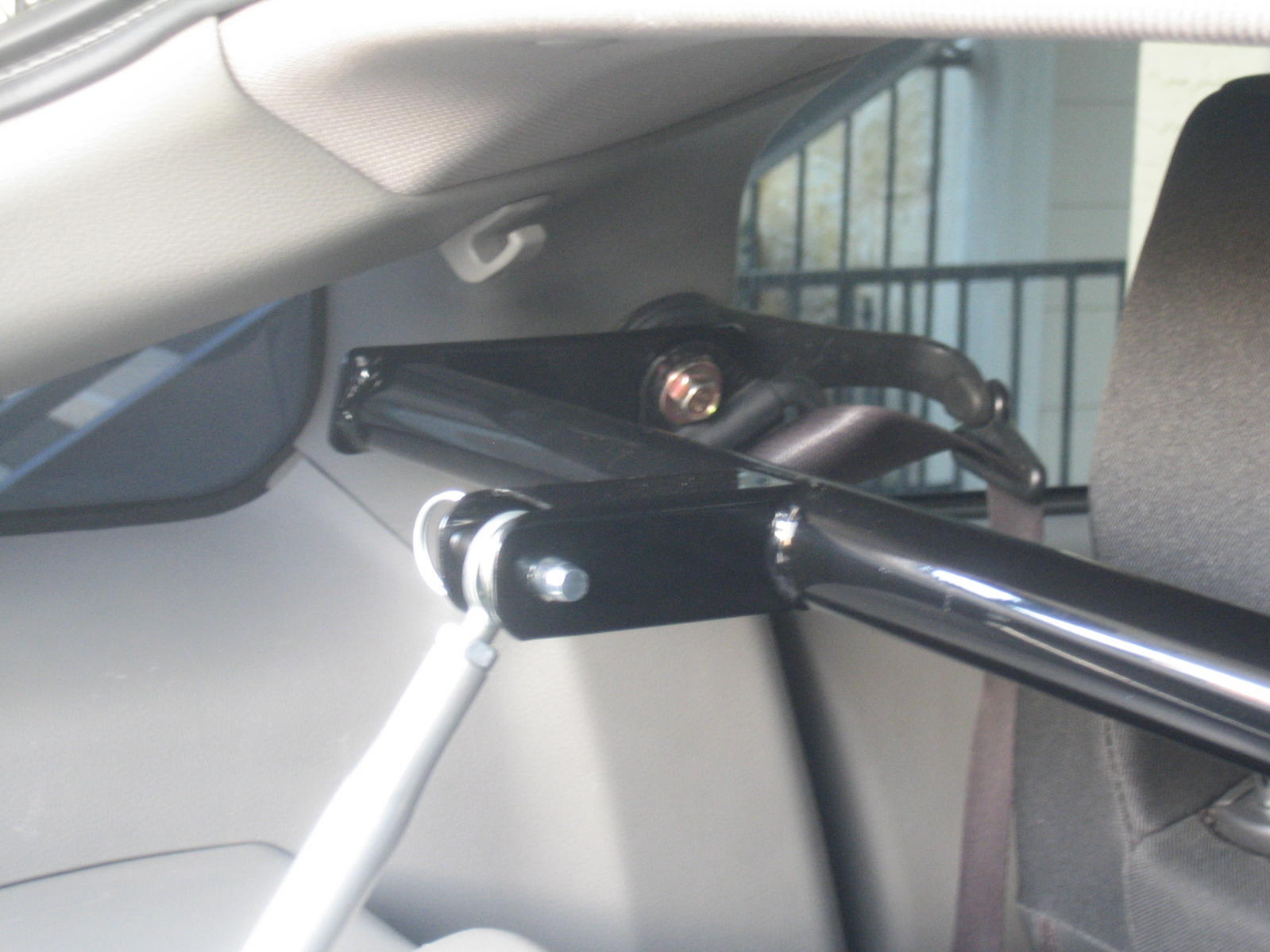

I recently welded a flange to the back of my custom harness bar for a permanent mount.....
