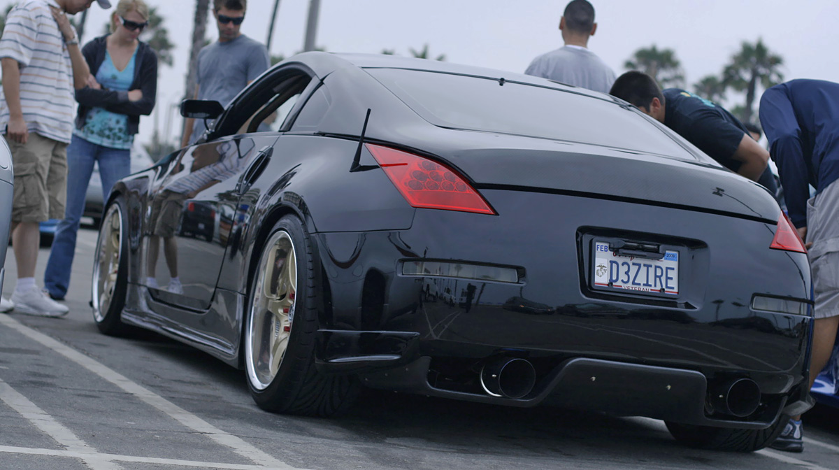

contact autoinfantry they are making parts so they might be able to help you out.
https://my350z.com/forum/exterior-an...ade-in-cf.html
Its definitely fixable, even though it was hacked up. Some of the cracks will somewhat still be seen but some sanding, and some minor touch up work with resin and it should look much better.
You can fill the gouges with some CLEAR Finishing resin and then clear it with a slight dark tint to the clear to mask some of the cracks. Overall its not too bad but it will just take some time to get it to look better. Let me know if you need help. DEFINITELY not worth to get it re-wrapped its gonna cost you just as much as a new piece. I'll have these finished up in about a week or so.
that's hot..!!
never thought it would look so nice. thnx for the ref.
