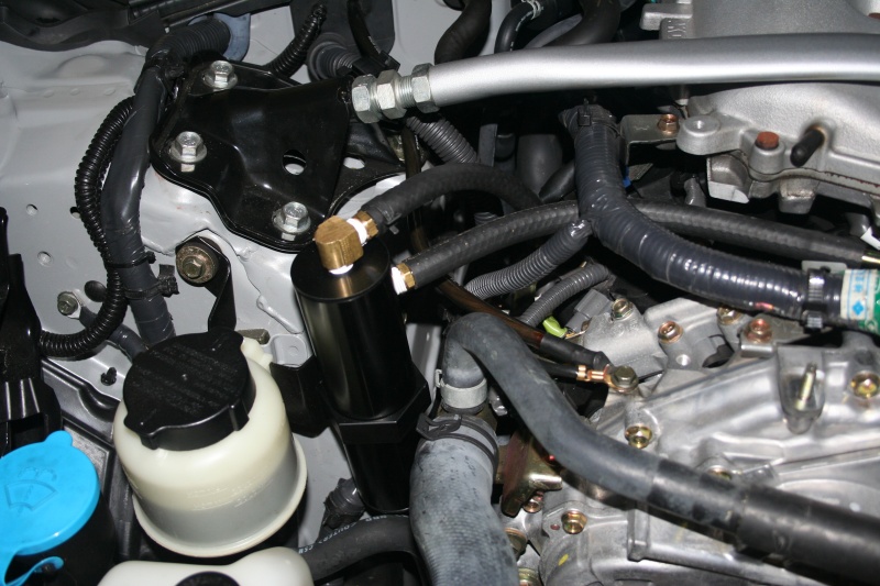

Well I got a new oil catch can and decided to mount it up so I opened the hood and holy shiz there is no room. Looked around and only found this spot!
Post pics of where you mounted it and if you rem having to remove anything to do it. Heres where I put it and used all the tubing provided.

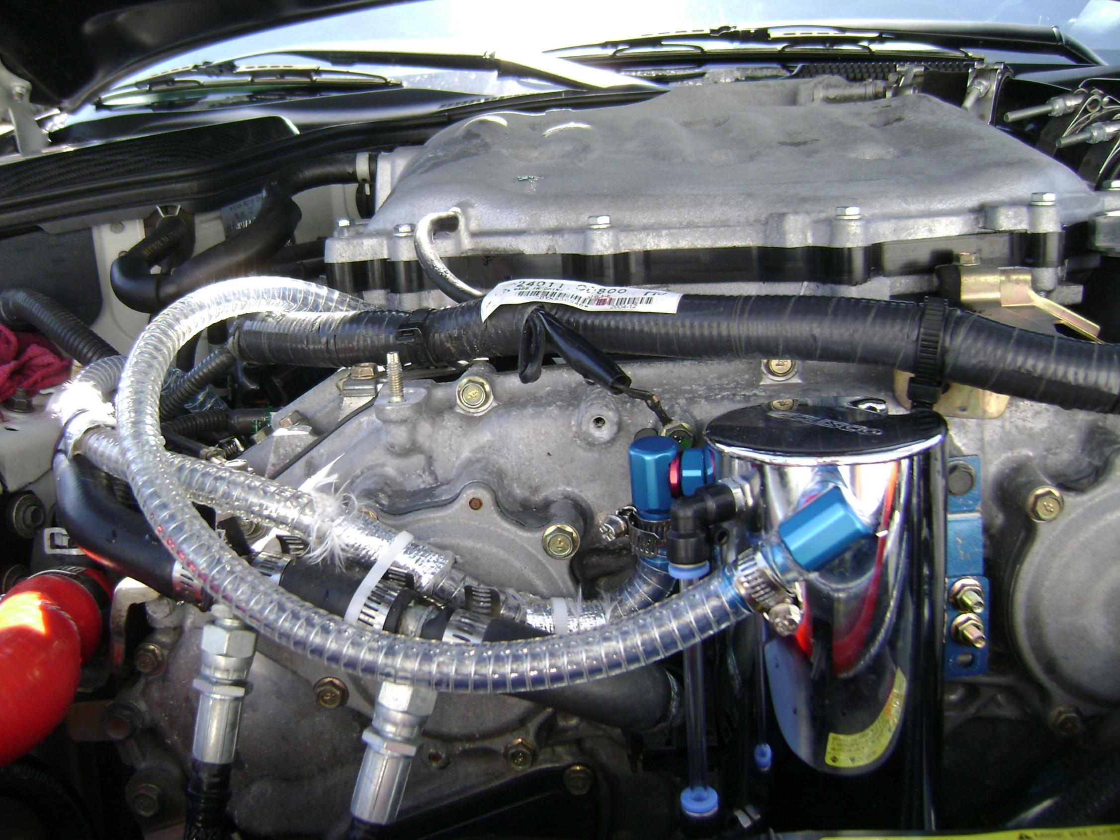

Heres mine.
Attached Thumbnails Oil catch can mounting location pic thread-catch-can.jpg

Originally Posted by RandyK1
Heres mine.
nice, yea was looking there first but my can is to thick. What type of can is that?

I got it from here http://www.customcorvetteaccessories...lcatchcan.html great price, and it looks good. I didnt think I needed something bigger.

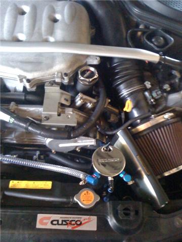

Here is mine. Yet another Custom Corvette Accessories Catch Can. Just installed it today. Still need to finish it up.
Attached Thumbnails Oil catch can mounting location pic thread-my_catch_can_-001.jpg
Mods pls move if in wrong section.
If thats the Greddy one I got the same one and mounted in the same place.
Here is a Greddy stealth mounted.
https://my350z.com/forum/7951708-post156.html
Heres mine.
looking at your pic you got the two hoses mixed up. the top is supposed to be the inlet and the one on the side is the outlet. i got the same one BTW
Damn, was wondering if having to much hose mattered but I guess not if you can hide it there.

heres mine
Attached Thumbnails Oil catch can mounting location pic thread-getattachment.aspx.jpg
Thanks, Its fixed now

Originally Posted by Escobar
heres mine
Looks like u followed the pic of the manual and plugged the plenum side. Correct?
