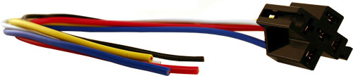

This looks like it should work for your setup.
Pin 86: Tie this into factory wiring that switches the fans on. (someone else may know which wire this is)
pin 87: Of course take this to the battery with a fused connection.
Pin 85: Chassis ground. Be sure it makes contact with bare metal.
Pin 30: This connects to whatever wire kicks on your fans.
I know you don't want to chop into the factory wiring but you need a remote turn on lead of some sort. And be sure to use a fuse going to the 12v+ line. Your fans should tell you how many amps of current they draw.
Hope this helps. It's been quite awhile since I've been wiring relays and other crazy stuff.
To make life easier get one of these:
Just Google 5 Pin Relay Harness to find one.
