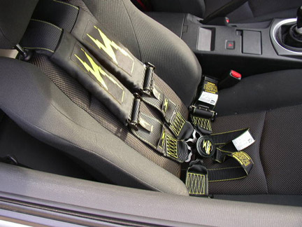

"I really wish the www.BCRLtd.net site had some pictures of those impact racing belts. "
So do I!
I'll see what my 'WEB-MASTER" can do.
In the pix, you can see how I run the sub belts under the seat back, so there is no way that one could slide forward.

What kind of harness is that the ib 6? Who makes it?
It is a BCRLtd custom made Impact Racing harness. The 350Z requires non standard belts to work as I have installed them.
Impact Racing is Bill Simpson's new company after getting f*cked by NASCAR & the Earnhart family.
BTW, I just checked a couple HPDE web sites, PCA & Car Guys, and they both do NOT allow 4 point harnesses. Must have a 5 or 6 point harness. The Chicago PCA site also requires 5 or 6 point harnesses to run their HPDE at Road America (and a Porsche ).
