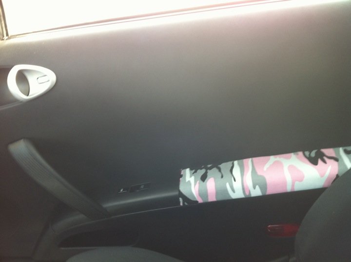

did mine in pink and grey camo. but didnt glue it just tucked it in all around came out pretty good. took maybe 5 minutes and is removeable at will. might go with a red and grey camo. pink was an experiment unless i get pink varrs
