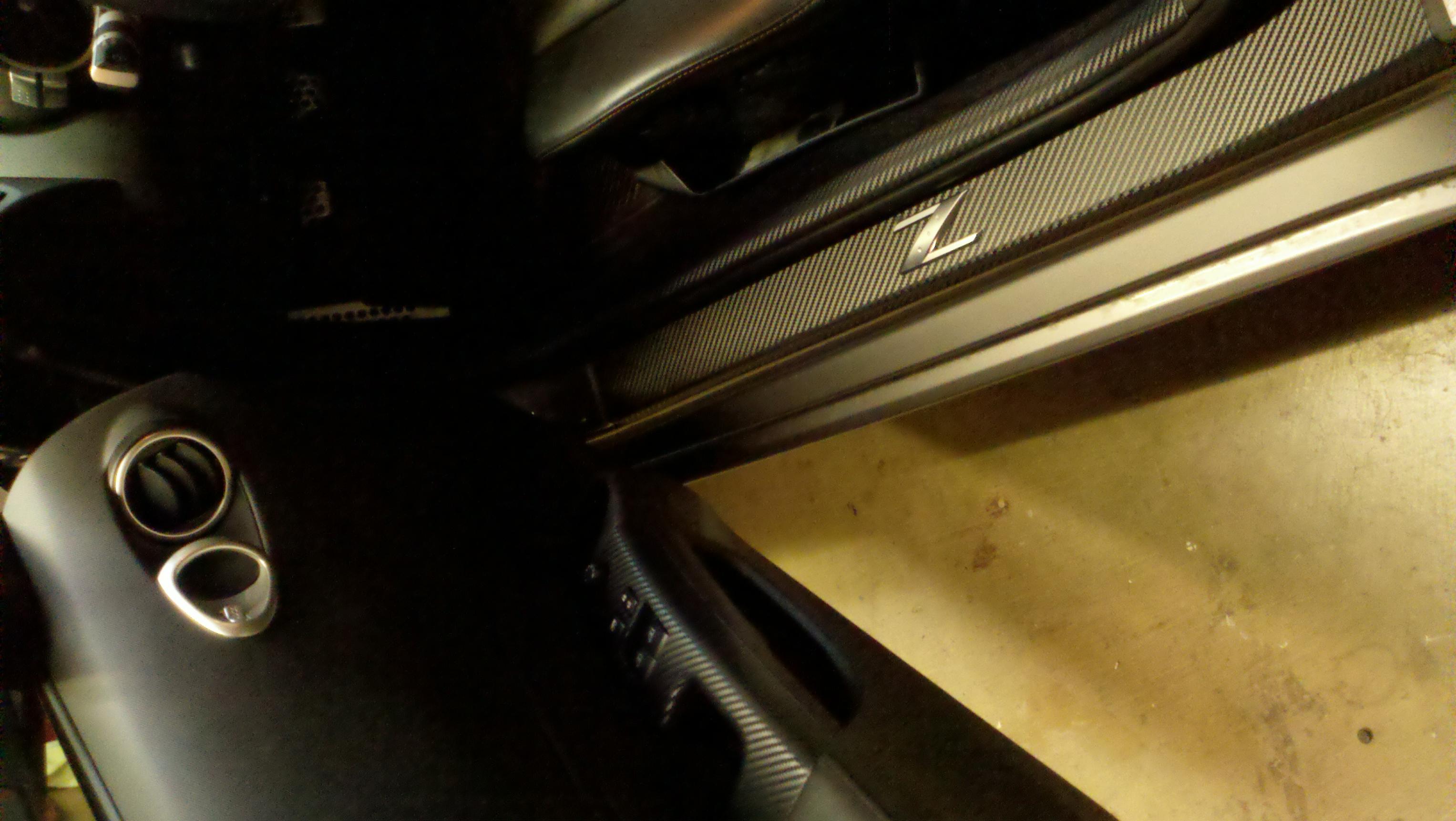

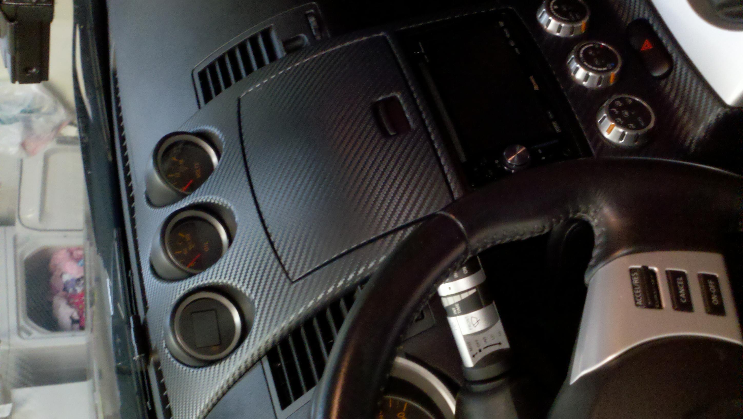

I recently finished my interior.
I HIGHLY recommend using the 3M primer to help adhesion around the edges.
