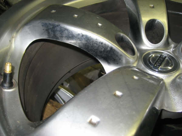

can i strip the paint and polish these style wheels on my car?i think spacer and polished would be sick as ****.
i know about polishing and repairing and polishing wheels. i know you can strip the clear off a factory coated polish wheel and polish. but i have never heard of stripping paint off a wheel and polishing. my biggest concern is the material under it? i dont know if its polishable or not. heres another member that did it but he has different wheels and they're rays so i dunno.i thought those wheels came painted but in his repair pics looks like the wheels were just polished with clear coat from the factory?

Yes you can.

I painted my stock 07 wheels and I can tell you from experience there is a lot of layers of s#!t on theses wheels to strip. You're going to have to take them down to bare aluminum, a lot of work. Make sure they're perfectly smooth. Polish them and definitely clear coat them. This all might be more work then it's worth in the end. The hyper silver factory paint looks good.

just realized i put this in the wrong section sorry. itd be alot of work but i think itd look good. plus my factorys are curber from the previous owner. wonder if you could just get them sand blasted?

OP, yes you can polish them, the first step would be to remove the paint.... You can have them bead blasted or you can use Aircraft aluminum stripper... The stripper would take several coats and a lot more sanding to achieve a smooth finish...
If you do decide to tackle this project, you better have a lot of time on your hands or have another set of wheels to drive on while you do it...

thank you sir. and yes you are correct. i personally like these wheels. if i ever get some spacers i think itll be a clean look. but i will definately eventually get wheels. i know it will take some time. if i could just find one spare wheel and tire i could do them one at a time. ive repaired a set of polished wheels before and i work in a body shop so im familiar with sanding ****. i personally like polished better then chrome and dont think theyre even relatively close to the same. polished is a cleaner shine imo

i got an idea of how to do it but it will be very time consuming. just in repairing polishing and painting some small sections on my old billet 22" wheels i had about 10hrs a wheel.

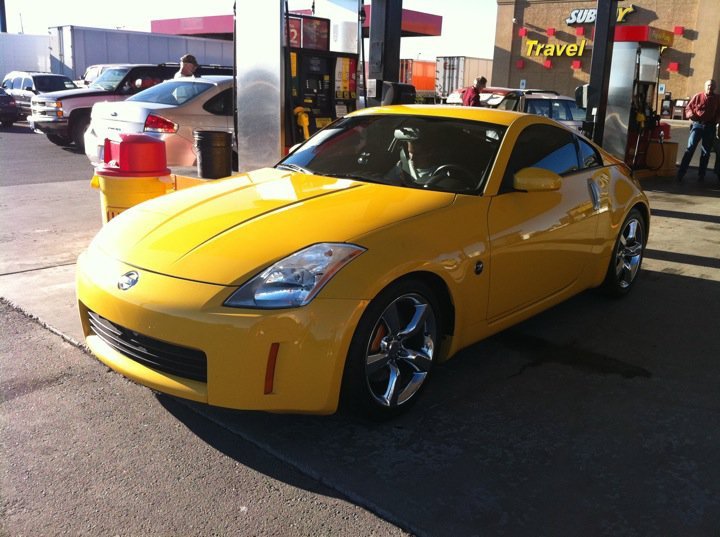

Mine is an '05 and I bought it used so I'm not 100% sure of the story behind the wheels, but they definitely look like they are the factory wheels that have been polished. Take a look:
Attached Thumbnails polishing factory 06 wheels?-63301_1422257200511_1355130088_31039312_6598287_n.jpg
