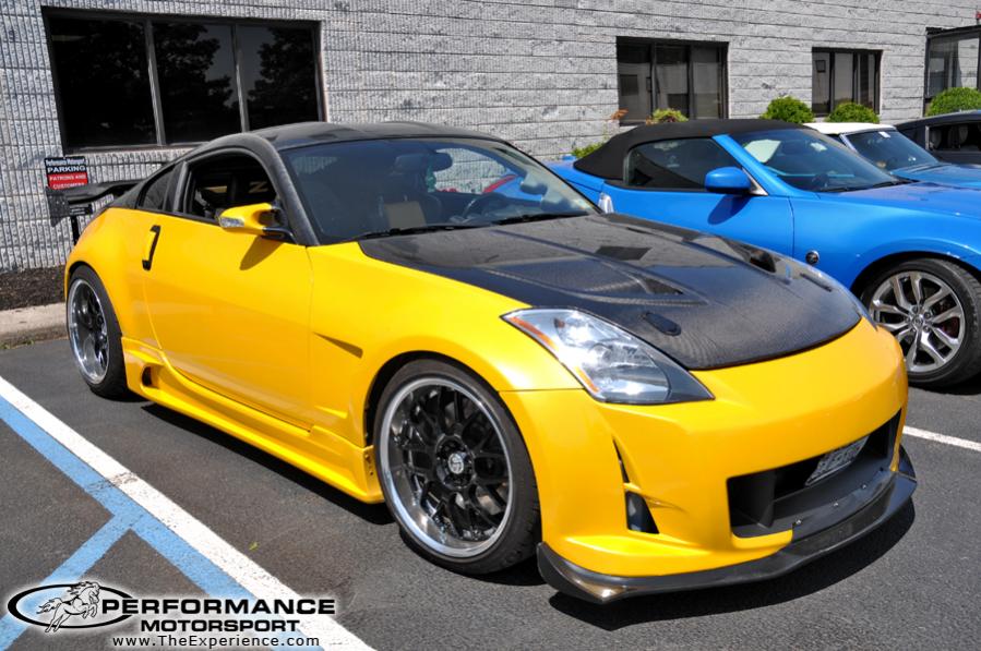

C West - currently on my car. Lined up well, didn't have to do anything, double metal latch, no hood pins (4 years now). This is a motorspor level hood, sold for a street car. If you want it to be show quality (at least in FRP form), you'll need to do some work. The upside is it's insanely light, even in FRP form. Even with the customization I've done (shaved 2 side vents), with the extra fiberglass and filler, it's still lighter than stock

Any chance we can get a pic of your hood? I have checked and only find the race car at an odd angle.

Wow.. that's sweet. I picked up an ASM but it's not carbon.

Not the c-west I was thinking of. Is there another?
Old Jun 18, 2011 | 09:48 AM
Flo-ridaZ33's Avatar
Flo-ridaZ33
iTrader: (60)
Posts: 9,203
Likes: 74
From: Miami
I remember the long nosed hood having louvers on both sides.

he filled in the vents bro.

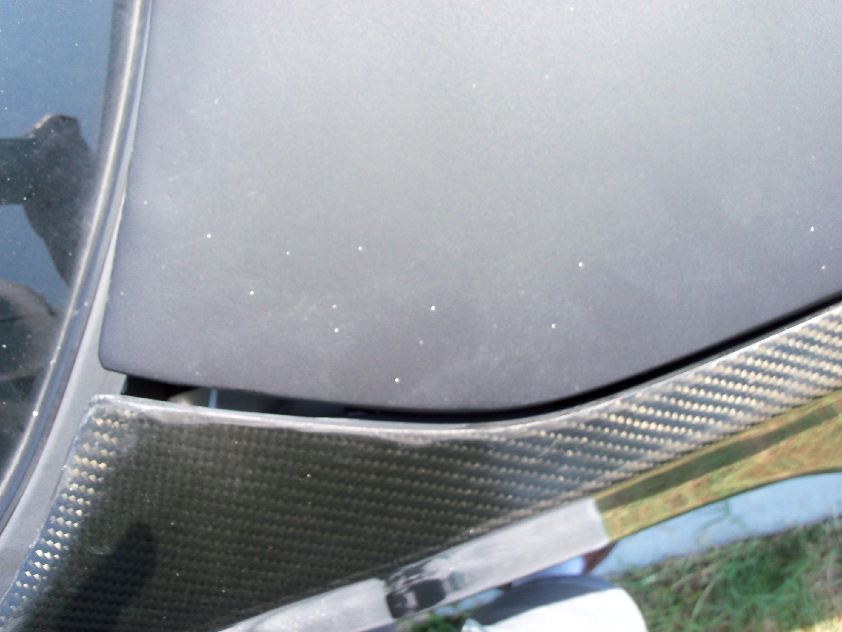

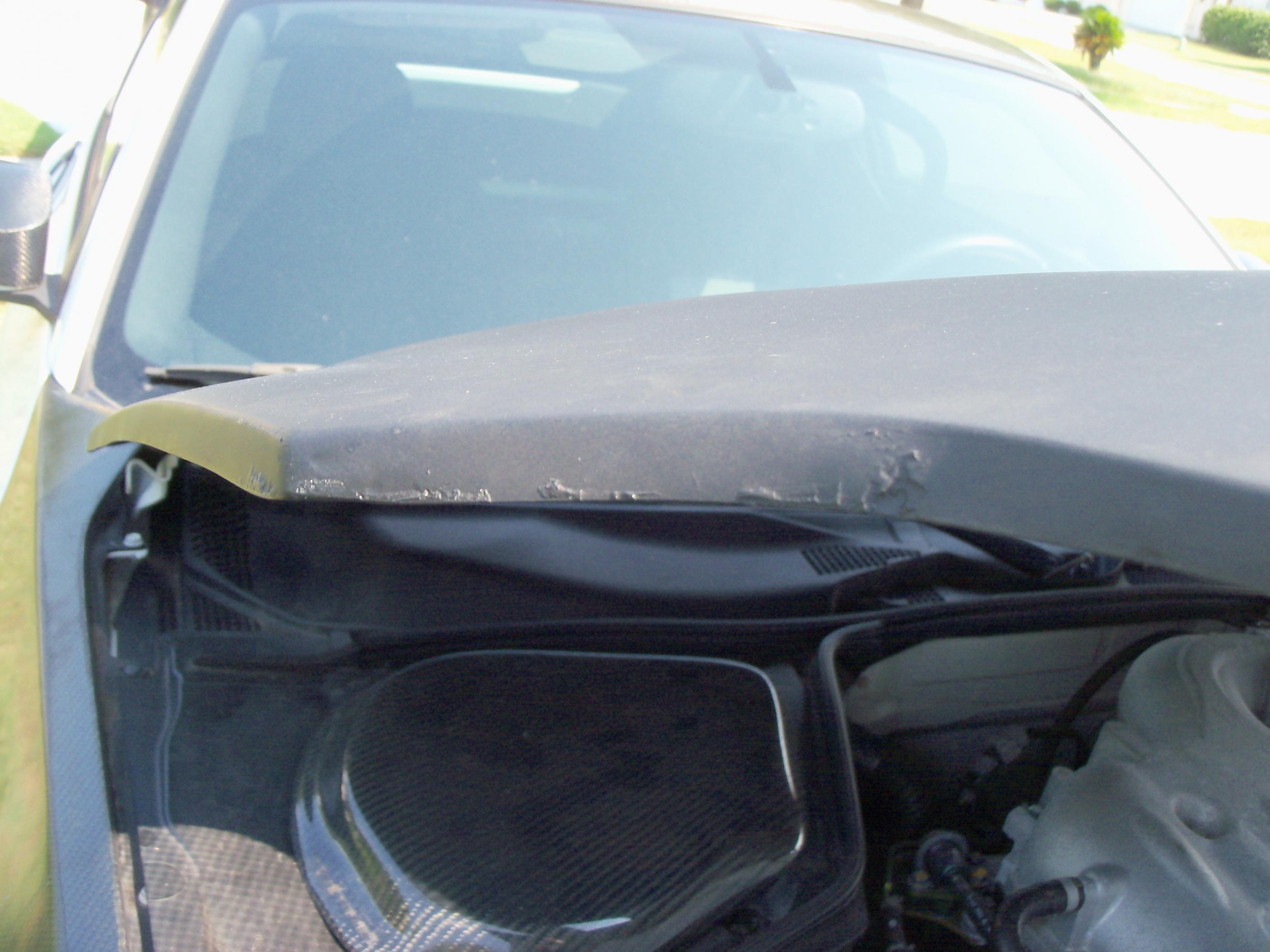

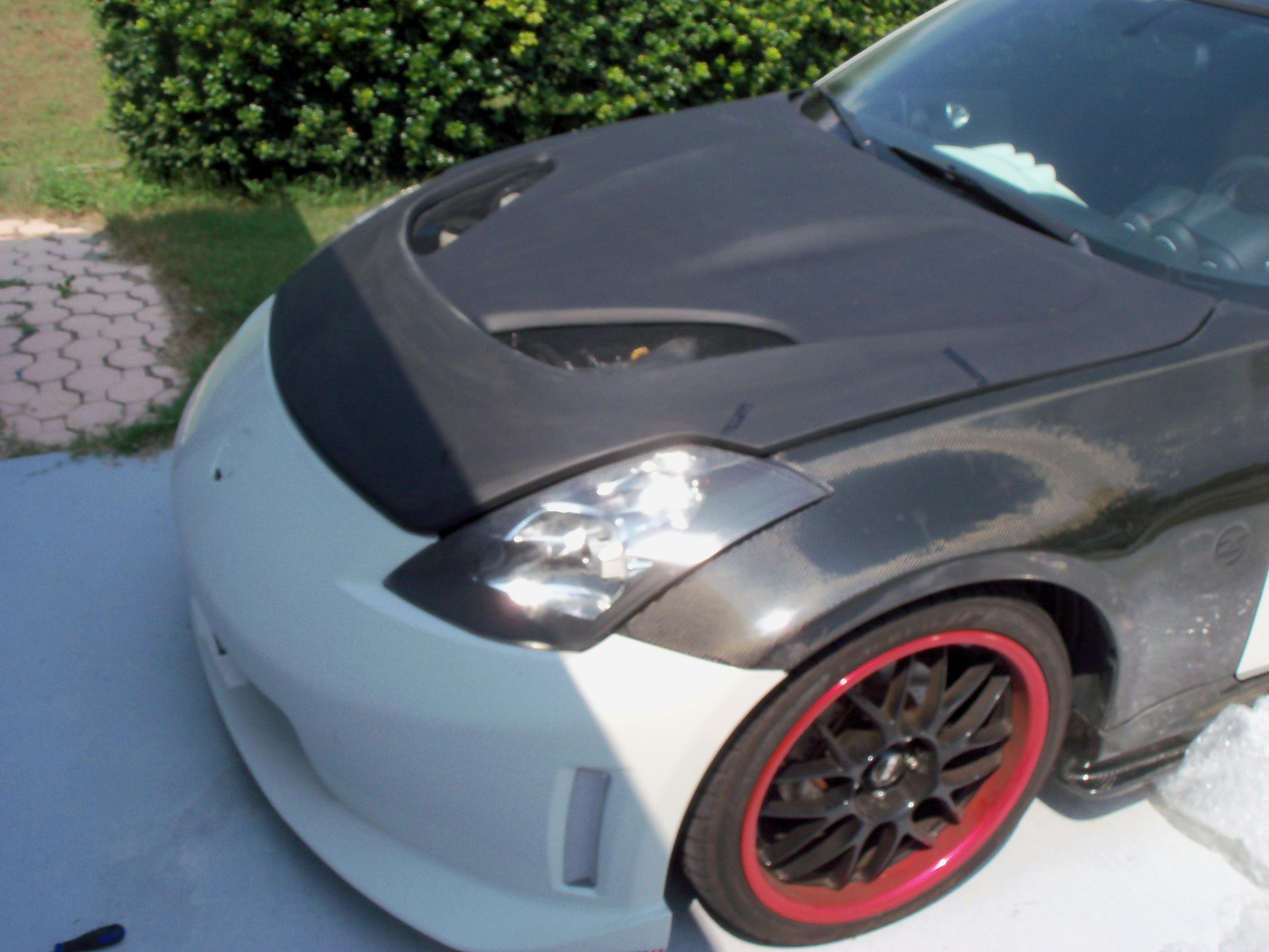

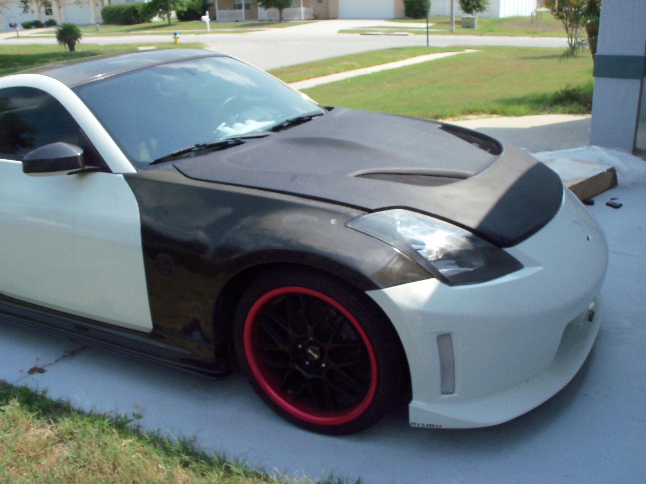

Here are some pics of my current headache.
Some shots from a couple feet back and one of the back laft passenger side that is a little gap.
Attached Thumbnails Hoods: Modding Hell-picture-002.jpg   Hoods: Modding Hell-picture-003.jpg   Hoods: Modding Hell-picture-005.jpg

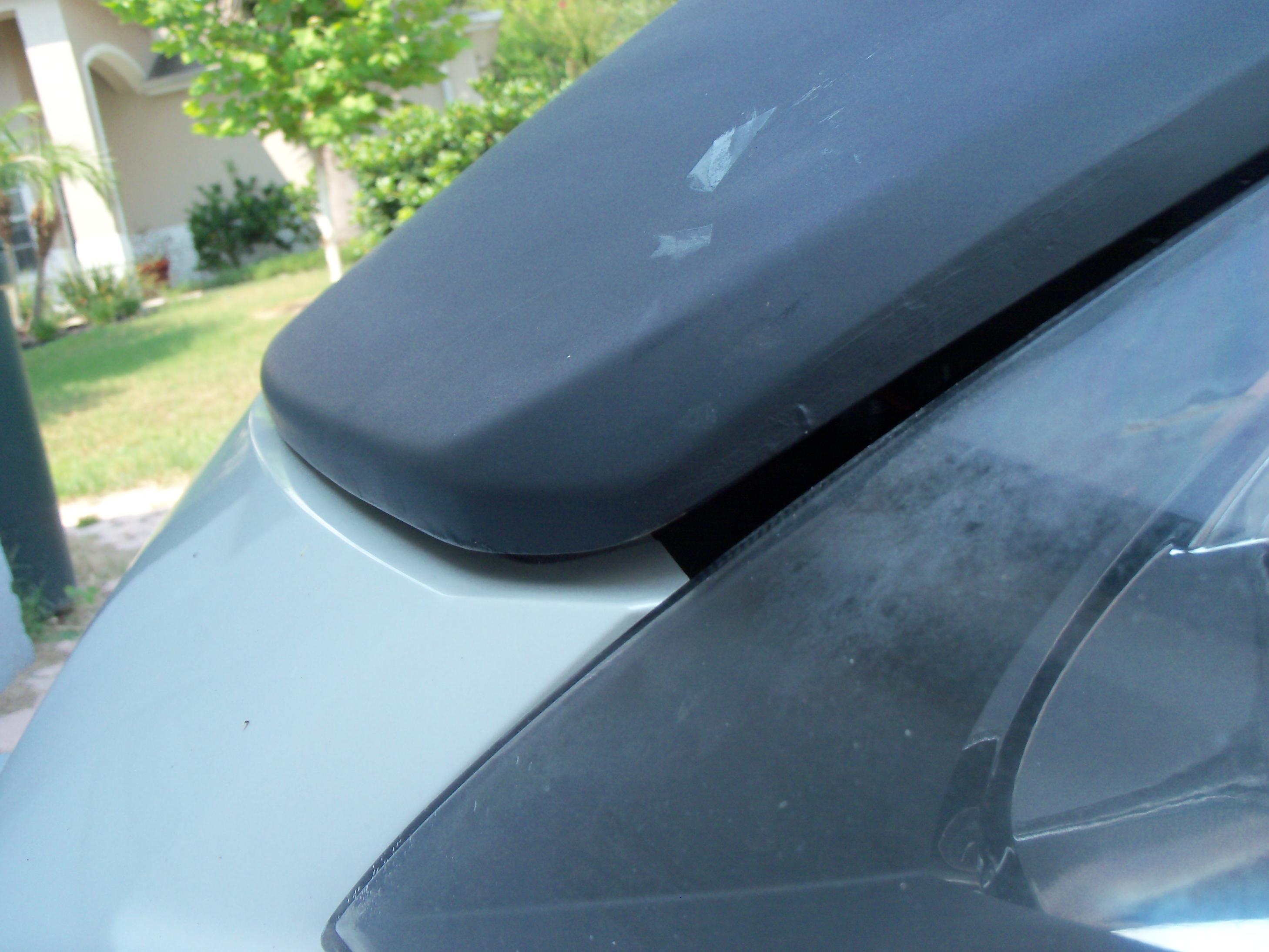

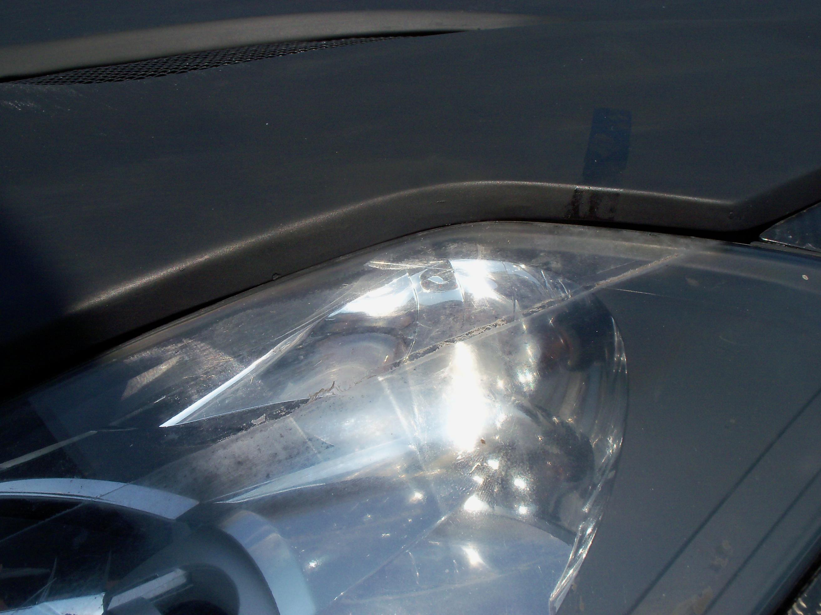

At the headlights there is this massive under lip that does not line up. and on the driver side uper right bumper/light corner is gaped.
Attached Thumbnails Hoods: Modding Hell-picture-007.jpg   Hoods: Modding Hell-picture-008.jpg   Hoods: Modding Hell-picture-009.jpg

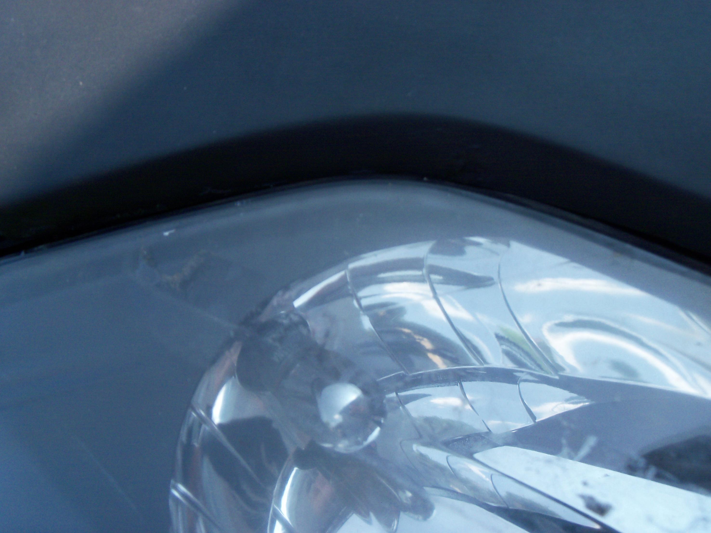

This is the masive lip I refer to, there is no room for that with my head light.
I am starting to shave that lip so it lines up better, but if you look at the bumper lineup I am on the bumper now. This means I will have to shave the entire front bumper line on the front underside of the hood.
Attached Thumbnails Hoods: Modding Hell-picture-010.jpg
