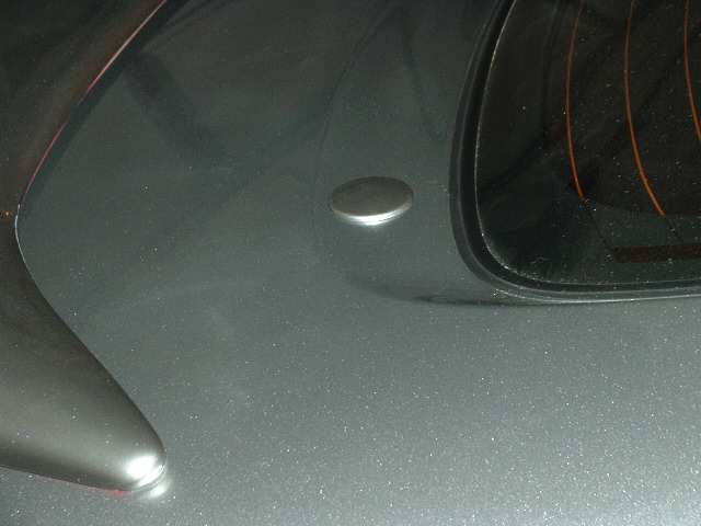

used a sink plug, sanded it down and had it painted by ZPRESENCE when he painted my wing and lip spoiler. Just got them tonite, better pics tomorrow.

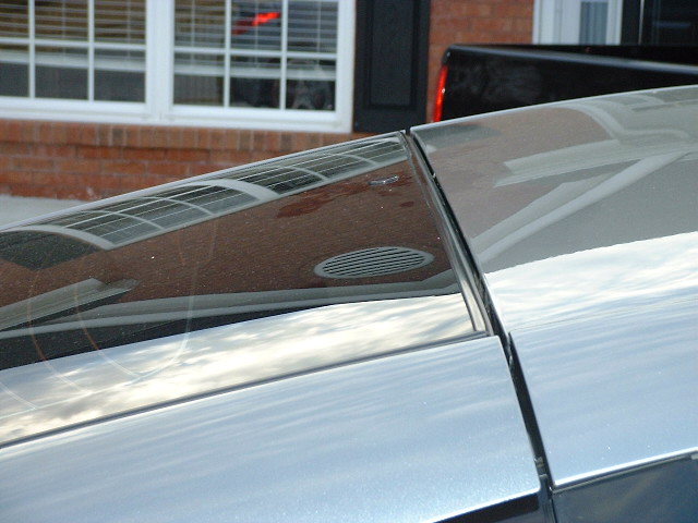

the wing is just sitting on the car at this point, not mounted. Stuff didn't arrive til after dark, and I spent about 4 hours getting the adhesive off from the stock wing.

beauty,... whats the diameter of the sink plug?

What wing did you get?

I'm still looking for a 1 inch plug all I can seem to find is 1 3/4.

not sure of the size without measuring, probably larger than 1", smaller than 1.75, but it could be 1.75, and wouldn't hurt to be a little smaller. I did round it off with sandpaper and my drill though, to give it a curved top. The wing is Data Systems Illusion.

Did you use any sealant between the hatch and plug?

I understand that. The only time I have ever used mine is when I hit the switch on accident.
The plug has a rubber seal, but I use silicone also.

Randall P on another board clued me into replacing the sprayer. Get a 7/26" metal cap from home depot (in the screw aisle, in a big bin) and paint it black. then silicone it in place.
