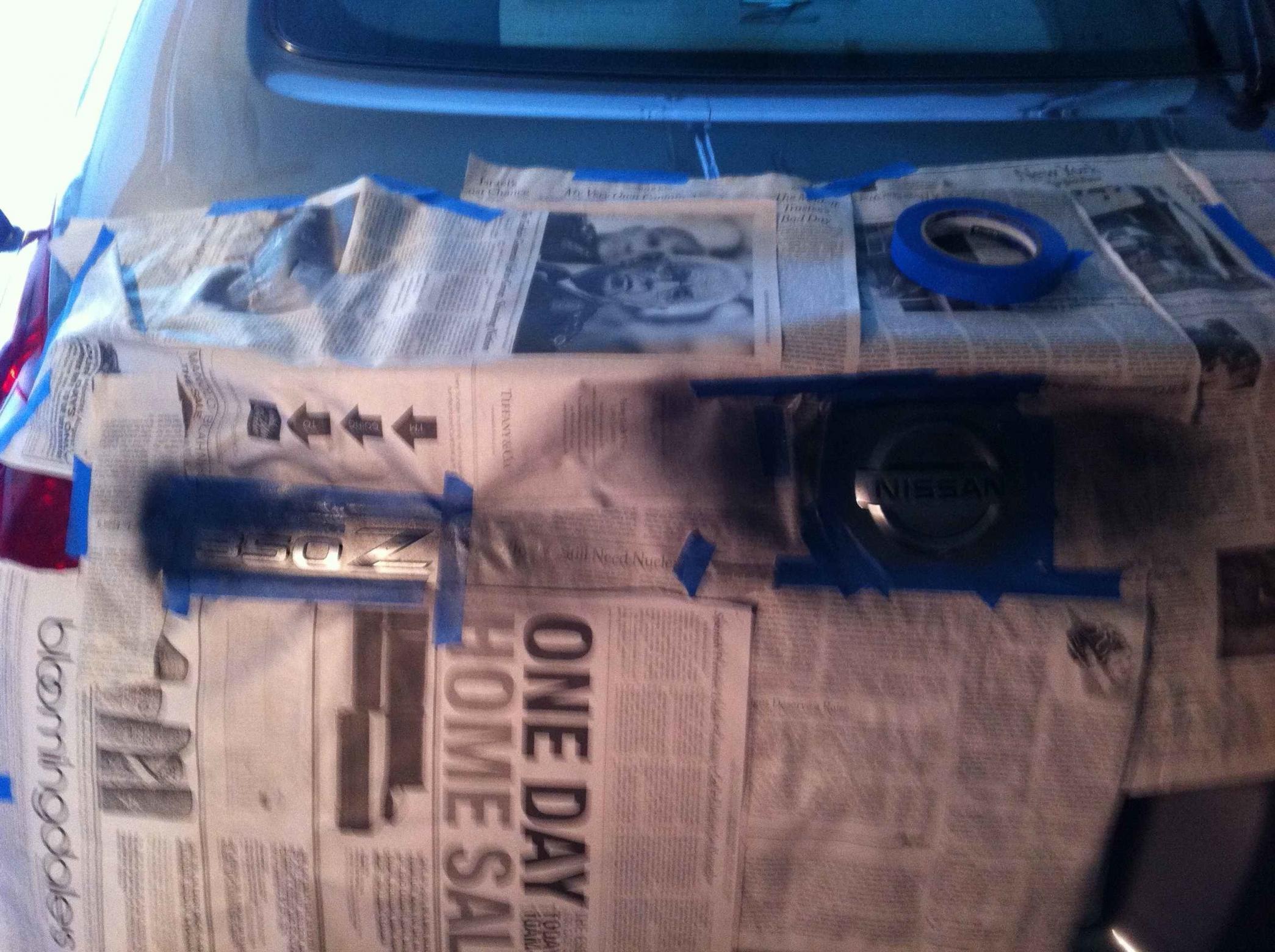

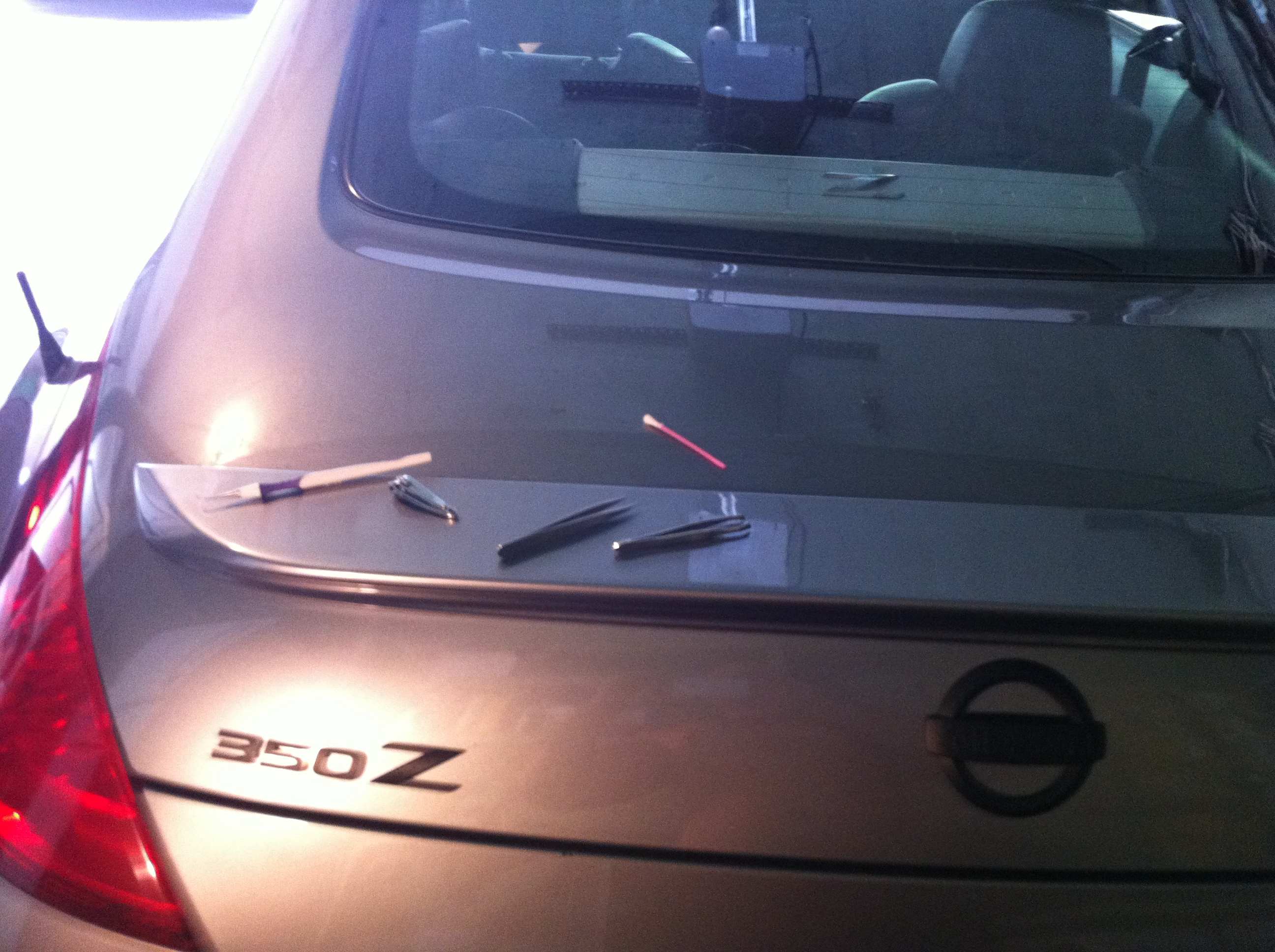

Today I had some free time and decided to black out the emblems on my Silverstone Z. It's an 04.5 Touring
Shout out to Pengu for giving me the idea/helping me through PM!
I used black Plasti-Dip and painters tape, and taped off the areas around the emblems... After the first spray I got nervous like i just spray painted my car black but this stuff is truly amazing.
Here are the pics, one shows the tools I used to get in-between the numbers and the hamburger emblems.
Let me know what you think, I think it came out well for a DIY, only took about 2 hours with drying and peeling...

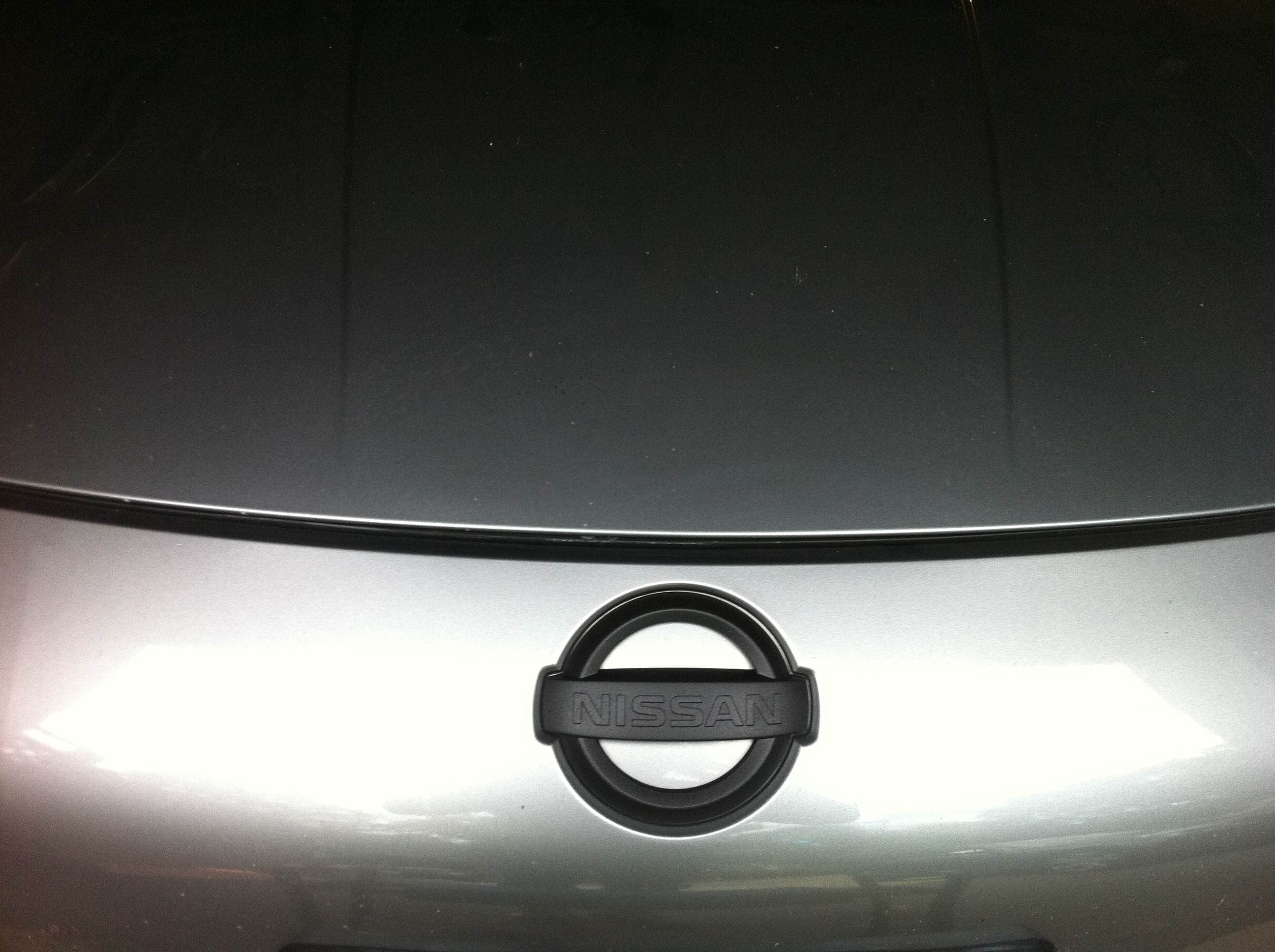

The front is such a PITA, just had to peel it and respray... it wont stick right so if it fails this time im gonna sand it down and then spray maybe that will help?
Rears are perfect...
