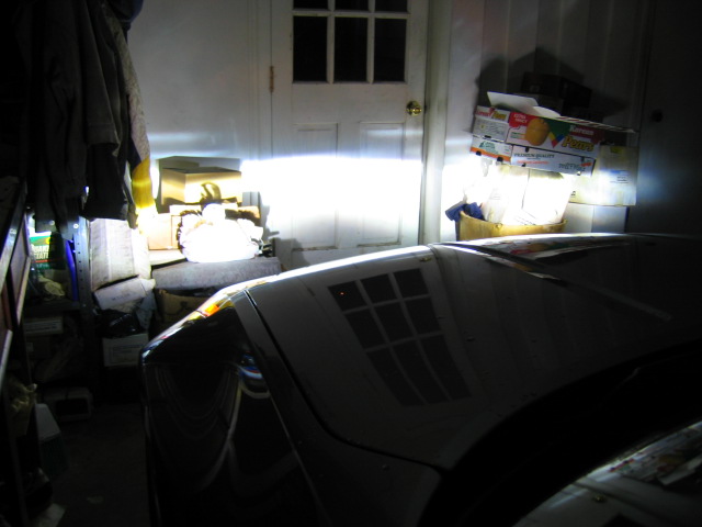

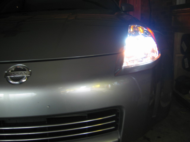

Heres some early pics. Sorry I couldn't fit both headlights all in one pic. Im standing as far back as I can in my garage.

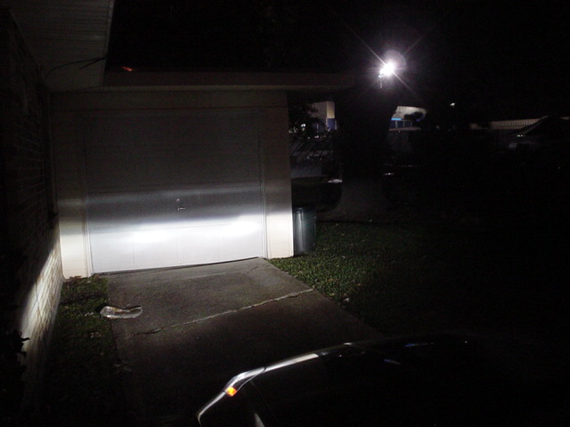

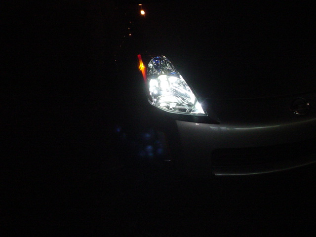

other side

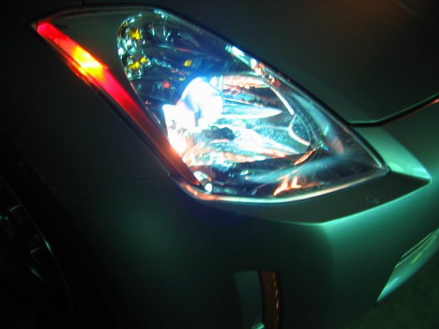

headlight charging up

Did you put D2S or D2Rs in? I put D2S in mine, and I get a slight light splash above the cutoff. Nothing terrible. We are supposed to have D2Rs in ours. In your last pic, see the faint line of light above the cutoff? That's what I am talking about.
If you got d2S's, then that solidifies in my mind that D2R's get rid of that.
But nobody has flashed me yet, so it must not be too offensive.

Thanks Dave. Ur output is just the same as mine. I think urs is much more brighter than the stock hids. Did u have to correct ur beam pattern. i noticed mine is pointing towards the right.

Mrgraphics,
I think mine is d2s too. the more i look at my output, I see what u r talking about. It most likely is the D2S.

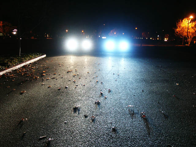

It look me a month to really nail an auction. I could have done a "buy now" via eBay, but I really wanted a good kit at the $200 range. I lucked out. Search for Philips hid kit or hella hid kit. You'll get the best hits that way.
My friend has an Accord and he put 6Ks in. They REALLY glare. So even though we put D2S in, they are nothing like his.
Here is a color comparison - notice how his corona's way more?
Old Dec 17, 2003 | 11:25 PM
  #40
MrGraphics's Avatar
MrGraphics
Posts: 314
From: California
Yet light output is the same - actually in person, mine illuminate further.
