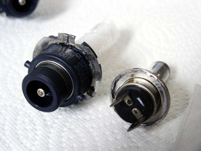

First thing I did was sacrifice an H7 bulb for the ring. I JB welded it on, and cut a bit of the D2S away to create the notch. When putting the ring on, the insulator wire should be pointing down, with the notch facing up.

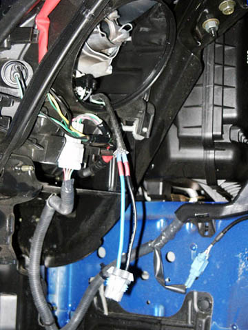

I mounted the ballast right under the headlight. It barely fit - took a bit of wedging. I JB Welded the ballast in place, and secured it with tie wraps. I also had to cut a bit of plastic away to make room for the new 9006 plug.

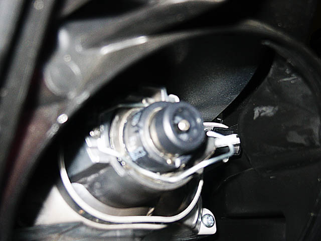

I then mounted the blubs in place. Remember folks - never touch a blub. The wire that keeps the bulb in place needs to be re-bent to allow for the new dimensions of the bulb. Its a bit of trial and error.

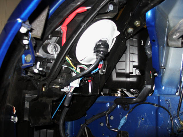

I cut a hole in the cover that seals the headlights up. Used a rubber grommet and the rubber thingy that came with the ballast. Sealed it up with some silicone and she be ready to turn on.

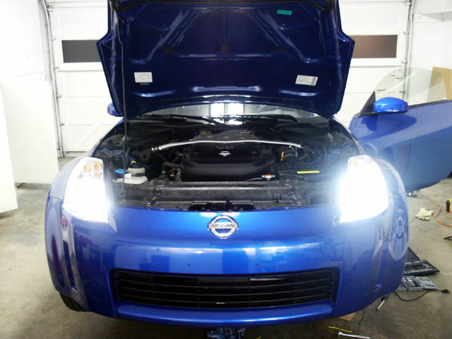

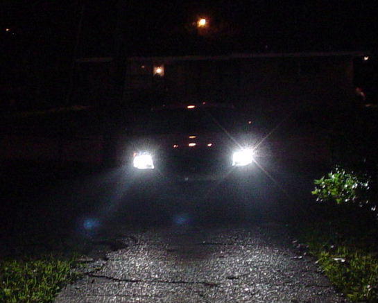

Here they are turned on. On the left are Silverstars, on the right the new HIDs. There definitly is a color difference, although my camera corrected it out. But the obvious difference in luminance is quite spectacular.
I'll have to see if I need to re-aim. If people start High-beaming me, I'll know for sure.
All told it took me way too long - most of the time trying to find the perfect location for the ballasts. When I did the second one, it took me about 45 minutes.

The silverstars are ok - but they definitely have a yellow look in person next to the HIDs. (the camera couldn't handle the light and just made a white hotspot.) I'd compare the difference to yellow teeth, and freshly whitened teeth.
The thing to notice is the luminence - see how the silverstars, you can still see the turn signal bulb? The HID's corona is way larger.
Silverstars just were not bright enough too - especially at night in the rain. Check out the auctions by the guy I mentioned above - with a little luck you'll get an auction that doesn't go to high. It took me a good month to get that price.
