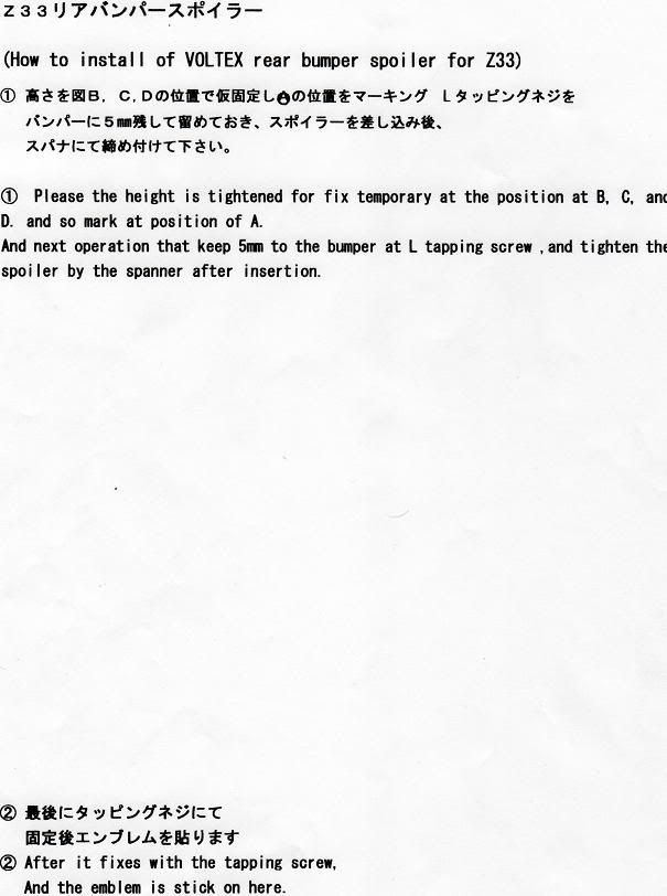

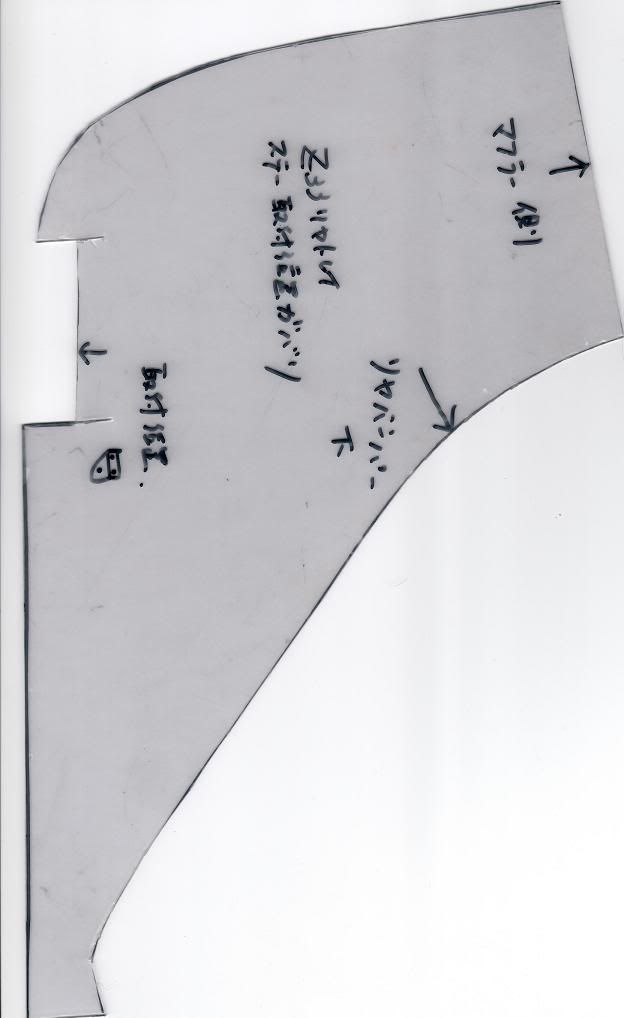

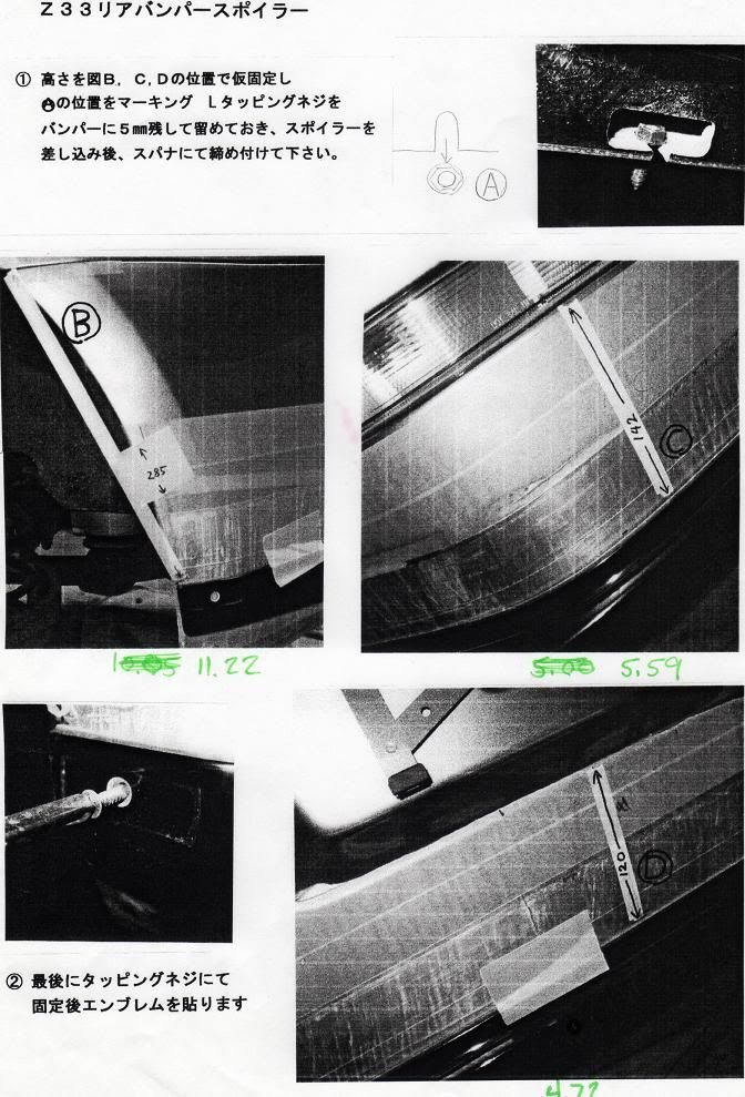

I realize I'm a little late, but this may help someone else out in the future...or not. I pretty much had to figure it out on my own. The template was a nice touch though. Just remember, "After it fixes with the tapping screw, and the emblem is stick on here". Why? Because Voltex.
