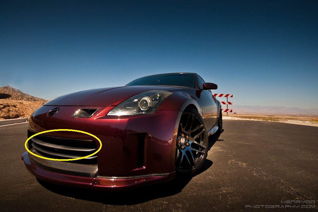

Like the title said, How do I remove the grills in 06-08 front bumper?? Do i have to remove the whole front bumper then remove the grills or I can just remove the grills easily with the front bumper on?
Thank you.
See pic below.

The easiest way is to remove the bumper and I believe a screwdriver will do the trick.
You should know that it won't remove the entire slot, only the top portion of each. You will need to cutout the section entirely if you want the slots gone.

Used a dremel on low speed with a cutting wheel on my '04.

I would remove the bumper cover, and see how the grill is integrated into the bumper. I know. Call me crazy.

yea lol i thought about doing that too and didnt know if there was a easy way without remove the front bumper. I guess that is my only option now.

Believe albinobob is correct. The bumper cover and grill are one piece for structural integrity. One piece manufacturing adds strength and limits flexing.

Yup, take the bumper off. They are screwed on individually.
EDIT: Are you talking about the grey pieces that attach to the grill or the entire grill slots?

There is a easy way and a harder way.
The easy way,although may take some refinishing,it to cut of the grille "blades" with
a multi-tool or,Dremel.The blades are made of a plastic,should be easy to cut at the ends.You would have to grind down the end,and/or cut off the screws that attach
the blades.You could use Dupli Color trim paint to refurb the grille cowl.
The harder way would be to reove the entire bumper and take off the blades by removing the screws.

i was planning to remove them so i can wrap them in CF vinyl di-noc so cutting is not a good idea since i want them back on lol..

It's a simple task to remove the front bumper and do the job right:
https://my350z.com/forum/body-interi...ss-06-ccs.html
