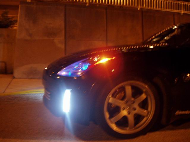

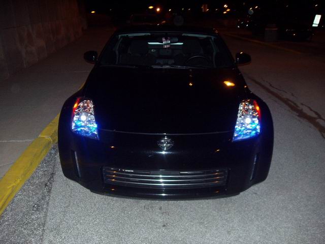

If you wish, you shall receive
Sorry for the dumb pics tho. I still don't know how to use this damn Olympus C-50.
Will try to get some better pix soon.
BTW, how does the LED sidemarker I also got from ares look?
Will try to get some better pix soon. BTW, how does the LED sidemarker I also got from ares look?
