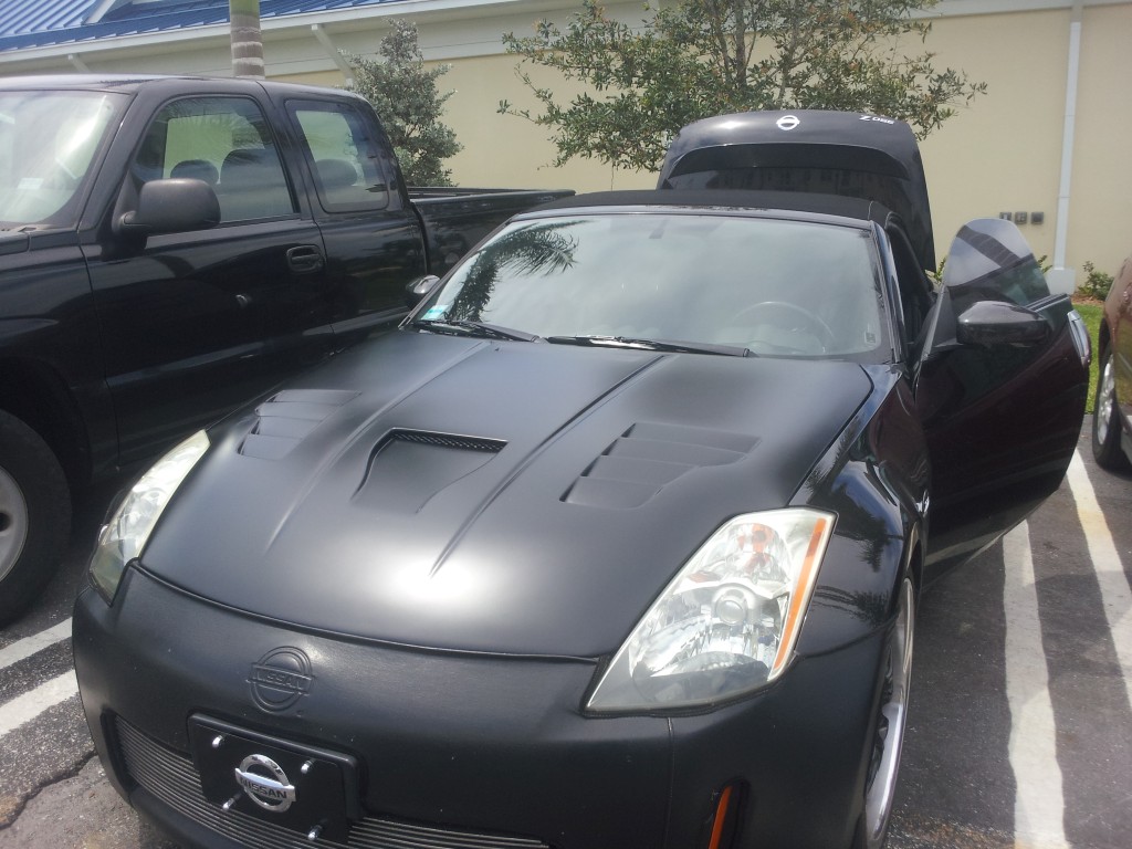

when i purchase my Z it came with two hoods, the factory and an aftermarket carbon fiber hood. off course i put the aftermarket hood right away after a fresh coat of Flat black paint. i'm locate in Florida and it rains here just about everyday, especially in the summer.
the new hood lets water into the engine bay and i notice after a heavy rain when is start the car i can hear the belt squeaking and my battery light goes crazy for a bit until the water gets pushed away by the motion of the belts.
I'm pretty sure it cant be good for the belts to be slipping like that or the alternator, is there any simple solutions to this problem? i was thinking maybe a cover that goes from the alternator to the engine. i found some that they sell but is only for the alternator.
any ideas? anyone else ran into this problem?
Thanks.

Put the stock hood back on.
If your car is N/A, what do you need a scoop for?

Obviously the CF hood is doing nothing function wise for your car.
You have it on there for looks.
You painted it flat black?Guys like CF because it LOOKS cool.No weight savings
Why?Was the clearcoat shot?
A common sense remedy would be to seal off the openings with fiberglass.
Paint that,flat black.

the car came with the hood.. i just like the hood style, but i didnt like the carbon fiber look that is why it was painted flat black.
i guess fiber glass will be the best solution, like you said is just there for the looks it serves no other functions than to make the owner happier.
Problem solved if you still want to keep that hood on

You may just have to tighten up the belt a little. I have had a vented hood on for years now and there is no issues with water.

And as for OP, are you sure your belt doesnt need a bit of tension?
