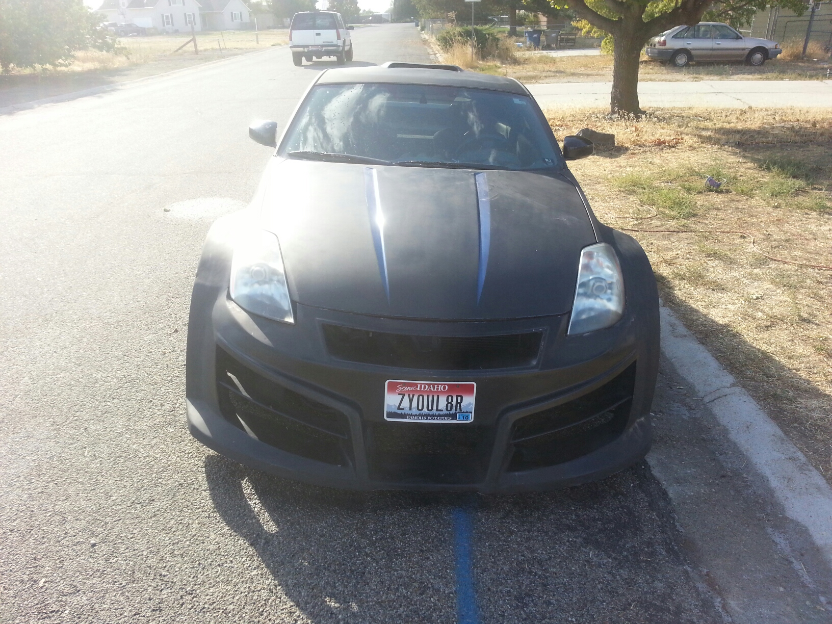

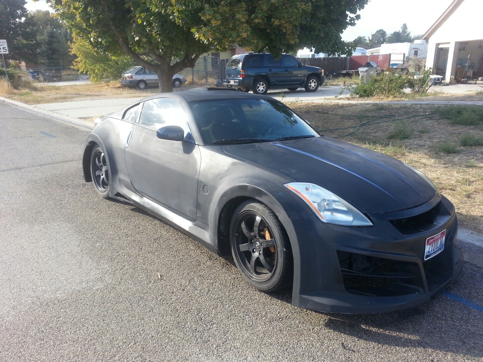

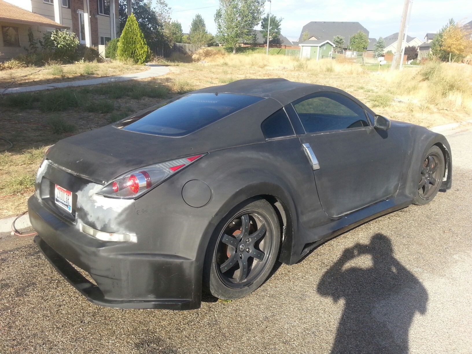

ok everyone. sorry its been so damn long since i posted here. had some issues keep me from getting tot he car for a long long time. i dusted her off last week though and dove in. here is where she sets right now. still smooth filling the kit into the factory body. decided to go unibody with it all. if all goes well ill be getting paint here soon for it.

God damn you fawked that car up something fierce.

Looks like you have a lot of work to go, I highly suggest not molding the front bumper to the fender.

terras, already is molded in. i modified the headlight so its easily removed without having to remove the front fender like it comes from the factory. this body kit was so ungodly rough that the amount of work to get the fender flares to line up smooth without being solid mold was just way to much. and theres planty of room since its such a massive nose to work behind it. yes i know its going to be a pain in the *** to do repair work on in the event of say a curb check. but once its completed it will be sold. the kit is fun to do but way to low setting for a daily driver. few more hours smooth filling and then it will be ready for paint and the nismo spoiler fitment.
