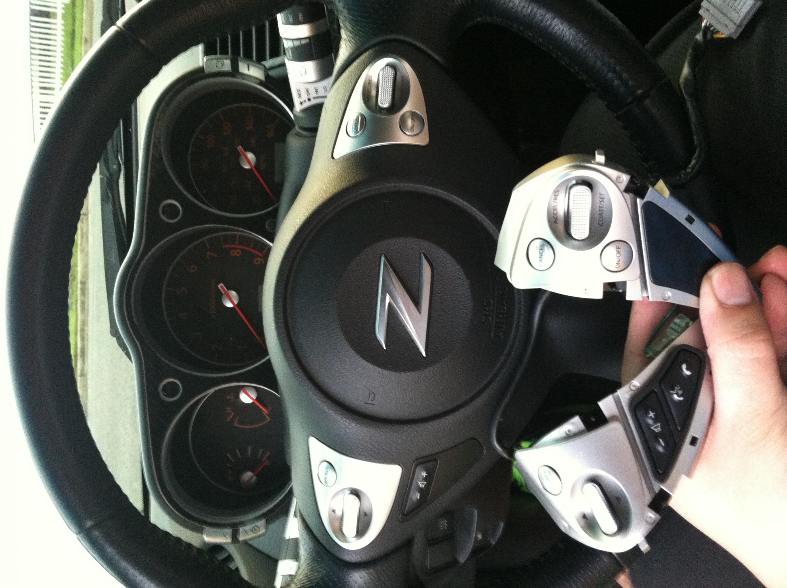

**Update
Everything WORKS!
Once the tools came, I immediately made the changes to the wire pins.

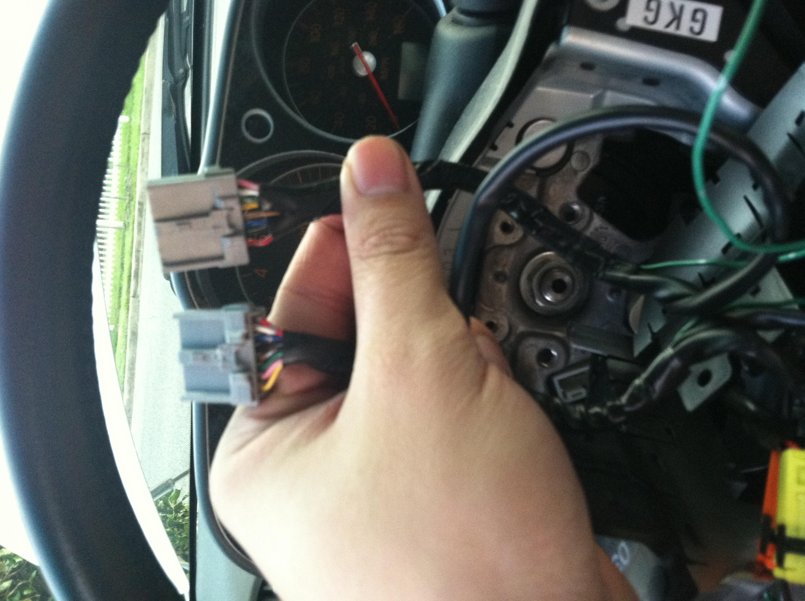

Here are the wire comparisons.
As the picture shows, the cruise system now works and the Horn noise is now activated in the middle of the airbag.

No the non-bluetooth steering wheel is not required. I have both and they work fine. The blue tooth would require the wires to be at different locations due to the addition of the bluetooth buttons. I just used the bluetooth for the time being until I can finish it completely. I do not have the time to finish it but I have some pictures to show the wire comparisons.
The left wire is what the 370z originally looks like while the one on the right is the modifications I made to make it work.
