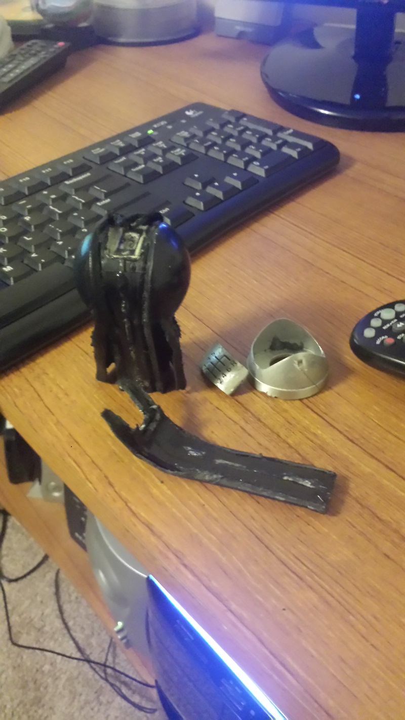

installed my new nismo shift **** today looks great but getting the old one off was a nightmare had to take the surrounding piece off, lock the shift lever with vise grips so it wouldn't move I didn't want to damage the transmission then use another pair of vise grips and twist like hell just to get it off heres whats left of the original **** no going back now i guess lol

i dont see how people mutilate it... mine came off easy, and sold if for $45...

mine was next to impossible to remove. I ended up using channellocks on it with a rag covering it- so i wouldn't destroy it. There was a bunch of loctitie on the threads when it finally came off.
i was replacing the clutch, had all oem parts so i doubt it had ever been off b4.

in 03 they used way to much locktite you can see blue on the threads it made it a ***** to get off on the newer models they made it a lot easier to get off

Mine is an '03.......but i do realize some folks have had a hard time with it. Hence my mentioning that it has been covered many times before. and Cudaben - I sincerely doubt that the factory used any loctite - someone had it off before. It has to come off to remove the waterfall so if that ever occurred for any repair or mod, then there ya go.

PERFZ -well being my car is relatively stock, i just replaced the oem clutch, and flywheel im doubting anyone has been in there. but thats just my thought. I am an ASE certified tech, and work in shop. I have done so for years... but I am probably just not mechanically inclined. LOL.
http://nissanhelp.com/diy/z/projects...ob_removal.php
nissan used a loctite type formula on many parts, bolts, and fasteners. the final drive is an example.
