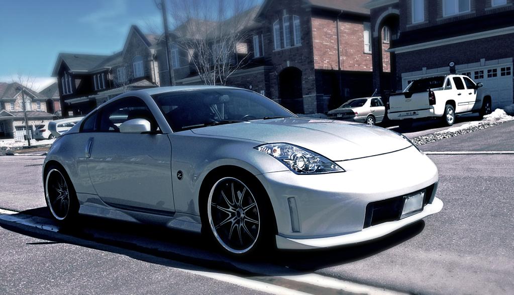

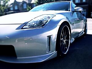

This thread needs some pics... I'm changed the paint scheme up on my V3 and went all silver and painted the inner grill black. Highly recommend the ZSpeed undershroud and extension... great products, excellent fitment!

that is so nice man ^^^^^^^^^^^^ great job
it looks like very good fitment
I have seen a few on here that fit not good , and they post it quite a bit
but mums the word

That's probably because they are replicas and cheap ones at that. A true V3 bumper will run you at least $700 new and will fit perfectly because its OEM.
