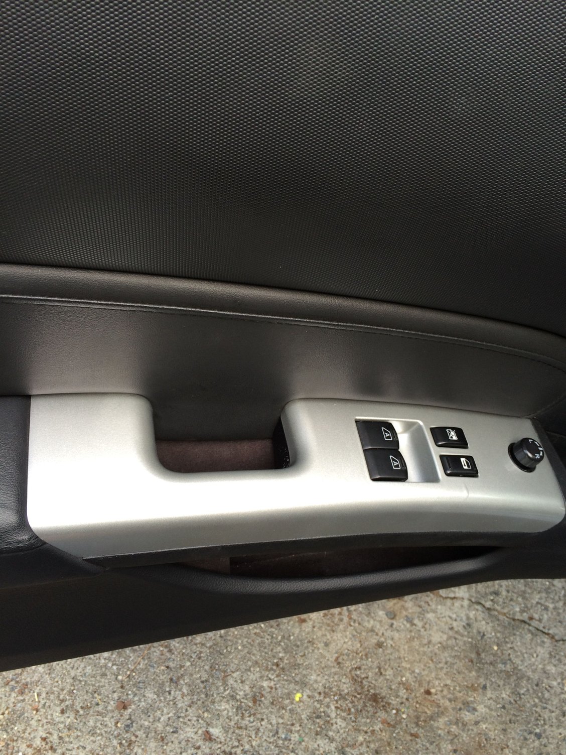

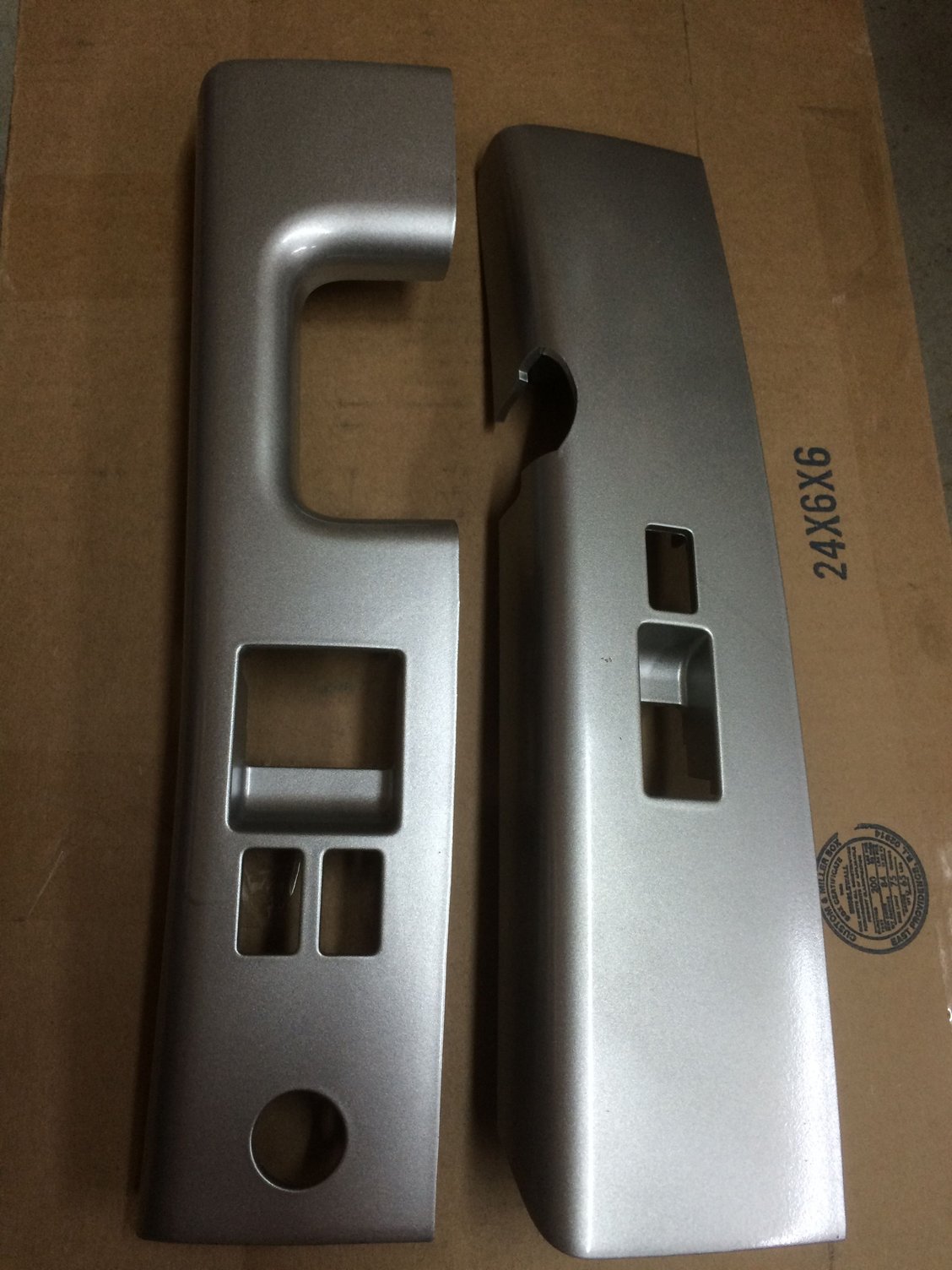

The window switch finishers in my 350Z were chipped and scratched, making the interior look old and rundown. I did not want to buy new ones only to have them look the same in a couple of years. I decided to paint mine silver as I always thought Nissan should have done this to break up all the black on the door. The color was a pretty close match for the other interior silver parts, I don't know if there is a better matching paint out there. I used Valspar plastic primer (Lowes) and Dupli-color silver wheel paint (HWP101) and Dupli-color clear wheel coating (HWP103). After I painted these, I waited a week to reinstall them as I have read about other people reinstalling them too soon and damaging the fresh paint.

The silver looks very good.
I agree that there is a lot of black in our interior. I've installed burnt orange accessory pieces with my seats to offset the black.

looks great!

Looks good, nice job
I might have to use this color for my scratched steering wheel cover if I decide to paint it silver

Reminds me of the G35 for some reason.
