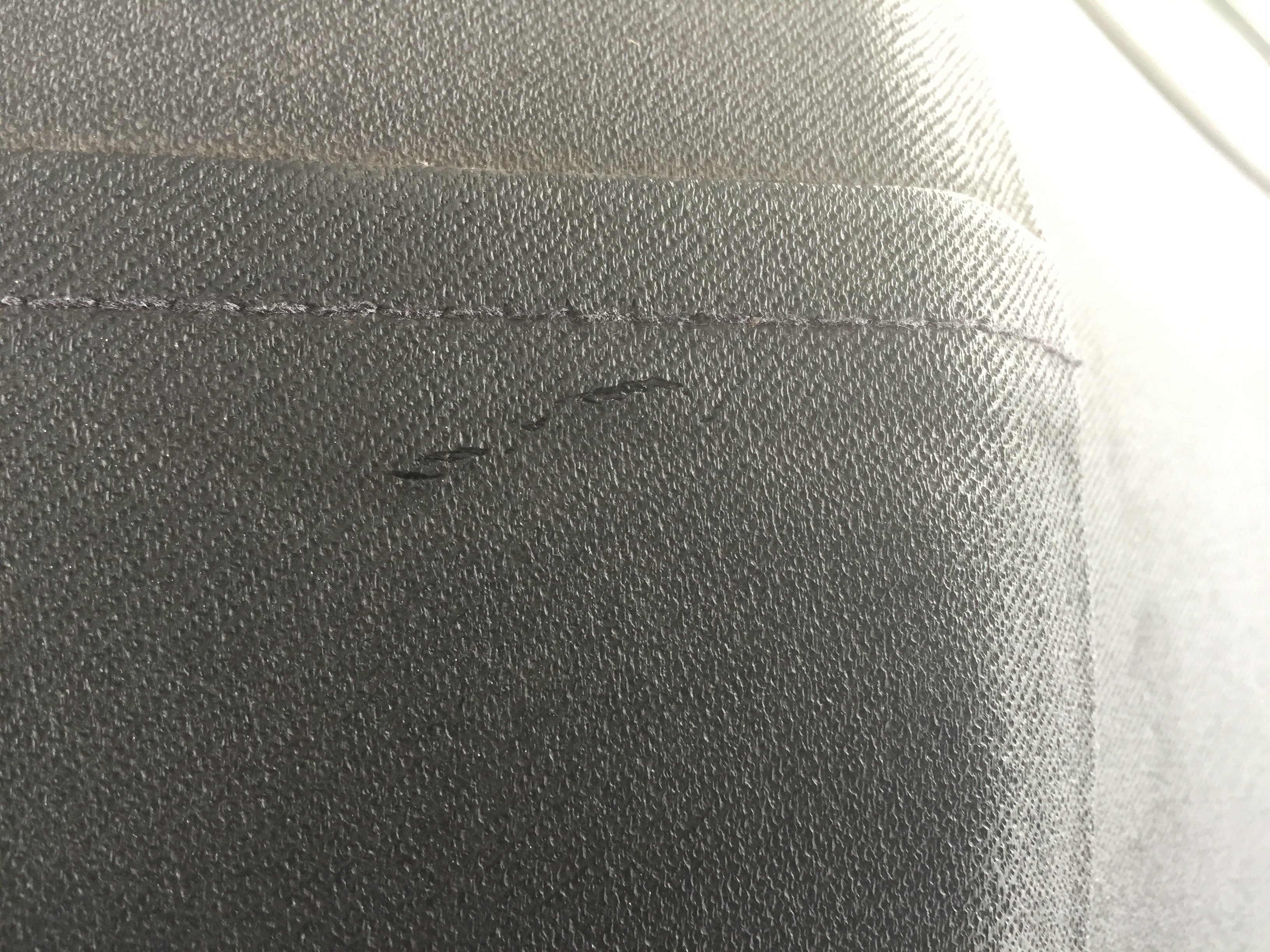

can I repair this crack in the top some how? or this bottom thing...
Top repair? and Anyone on here have the Smooth-line hardtop for the roadster?-img_4763.jpg
Top repair? and Anyone on here have the Smooth-line hardtop for the roadster?-img_4762.jpg
smoothline HARDTOP: Iv'e been looking at them and cannot make a choice I love them but they are wayyy to expensive at $1800 base?! the cars only worth $5500 as it sits... looking for info maybe tips? some kinda help my top just ripped and im in the market to buy a hardtop/soft top... only have $500 bucks and I suck at installs lol.... located in florida

I have an 06, the soft top began ripping behind the side windows. I researched forever and decided to sew the tears with black #50 braided fishing line. Worked great, but the tears reappeared right next to the repairs because the fabric was too fragile.
Bottom line, I bought a new Haartz Stayfast fabric top from topsonline.com. It came in 4 days, cost $650.00 and I did it with no help in my garage. It's not rocket science, but there are many steps. I'm glad I did it this way, I hate paying someone to do something I can learn to do. Good luck.

Haha man that's nothing. Stitch that and put a patch under the back.
I've got like 2- 3" long rips on mine. Just going to throw some patches with some fabric 3M upholstery epoxy I got and call it good. I live in CA and think the tops are ugly up and probably going to run mine down 90% of the time. I'm almost tempted to just take the thing out
