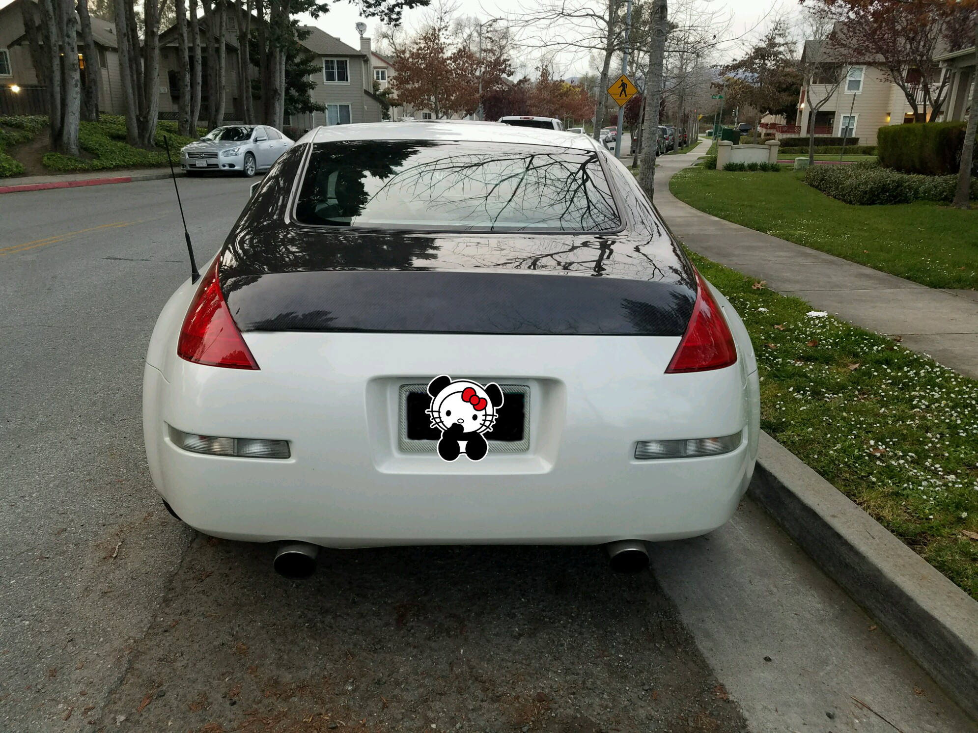

In the mean time, here's how she looks so far. I'm planning on slapping some louvers and the visor tomorrow. As for the wing, gatta wait 2 weeks for it to arrive in the mail. I love the waiting game.
Attached Thumbnails Carbon Trunk vs OEM Hatch Struts-20170309_175857.jpg   Carbon Trunk vs OEM Hatch Struts-20170309_175909.jpg   Carbon Trunk vs OEM Hatch Struts-20170309_175921.jpg   Carbon Trunk vs OEM Hatch Struts-20170309_175931.jpg
