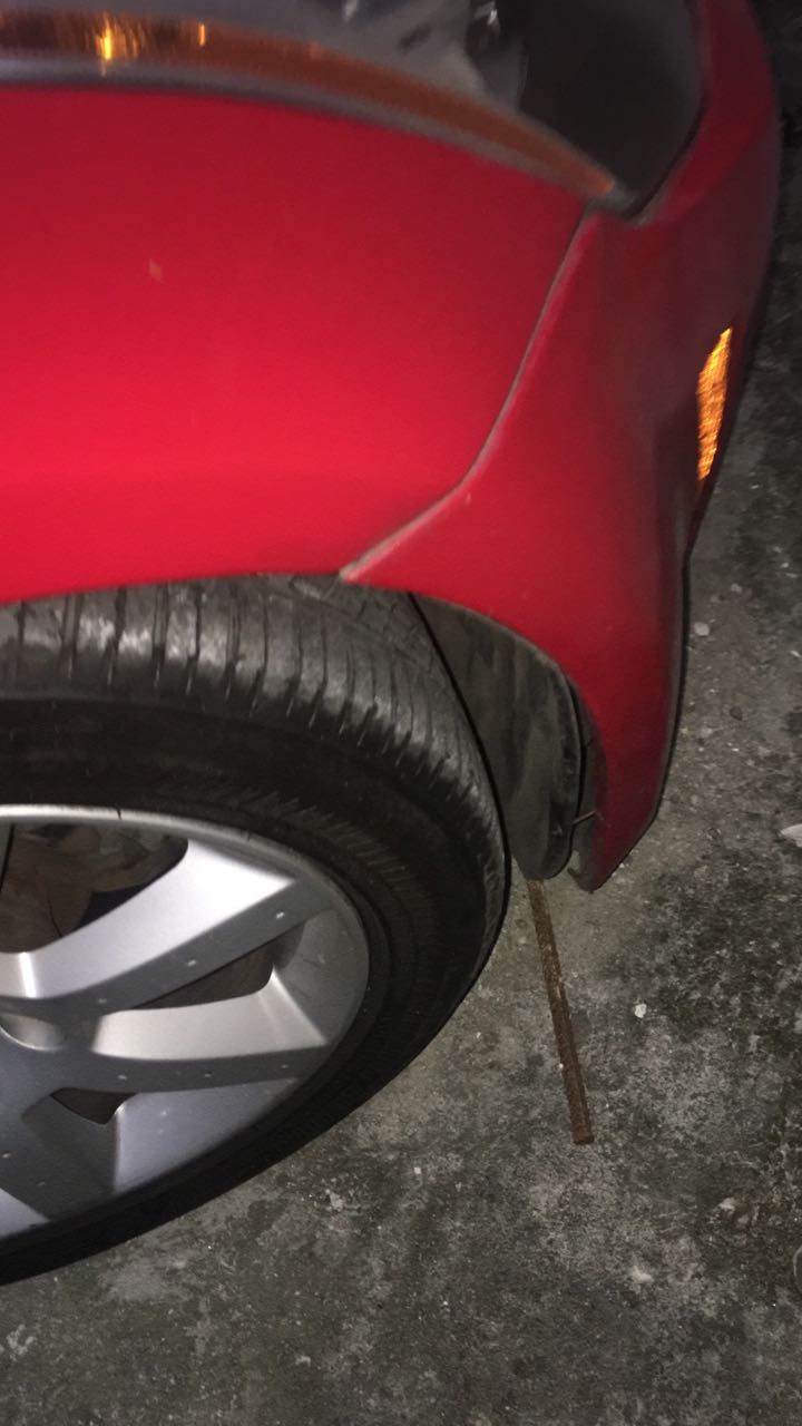

Hi, I'm a bit confused. I'd like to know what are the correct clips or nails for the splash shield bumper infront of the front tires.
I have these 2 examples.
Attached Thumbnails Correct clips/nails for Splash shield-9a2122c7-3faf-4054-9b64-a066ac6eabd6.jpg   Correct clips/nails for Splash shield-9d208162-3aca-4a8e-b6a3-c90f76446442.jpg   Correct clips/nails for Splash shield-f8d65325-2729-4501-824f-680cd69253d5.jpg

neither of those is 100%. You do need 2 to 3 of the first one per fender liner. They should me m6x1.0. Bolts are nicer when they are longer and have a cone on the end for lead in.
You need fender liner push type retainers. similar to the bumper ones but shorter and wider top.
