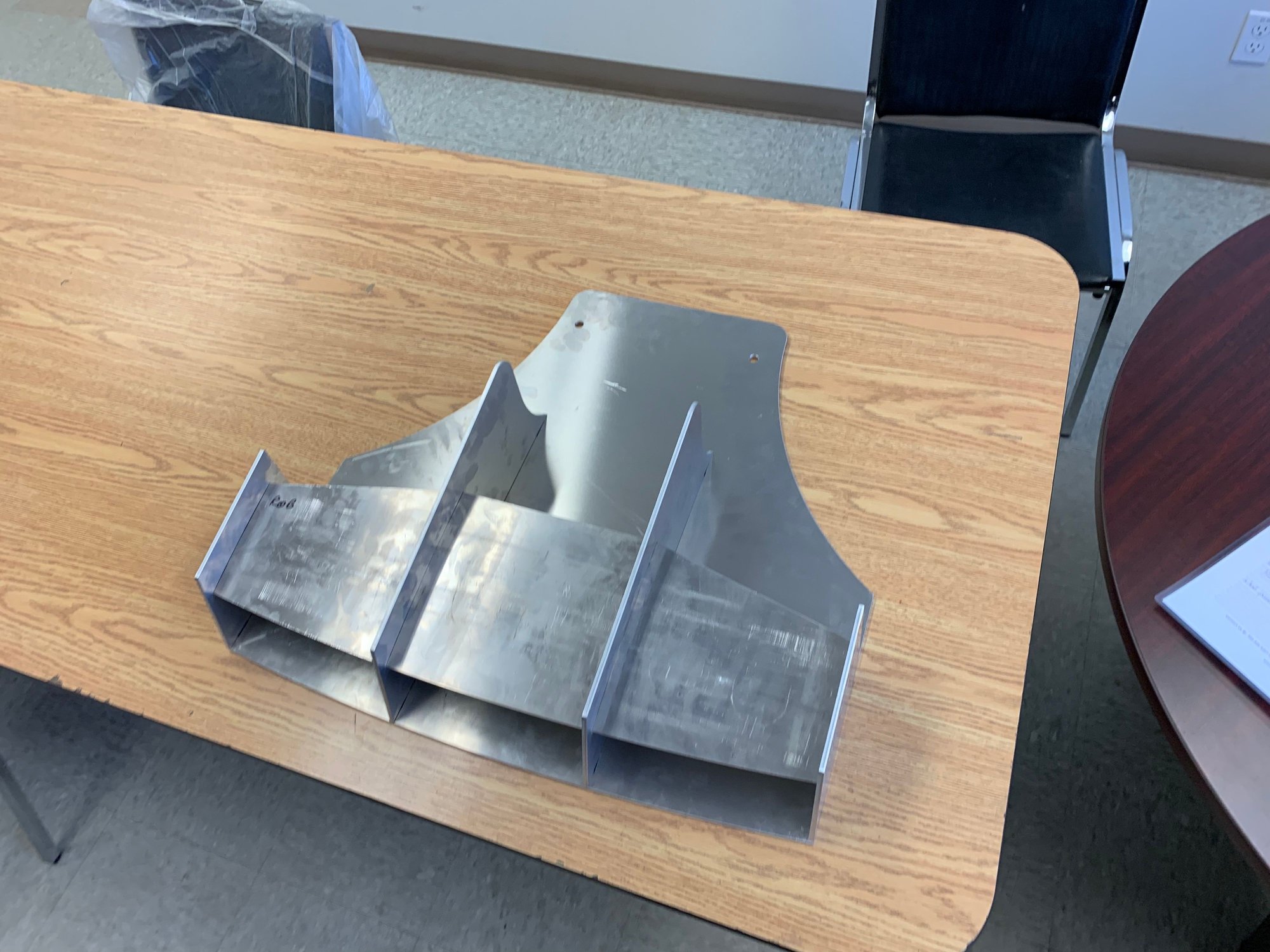

So I got out the CAD and designed a rear diffuser that flattens the space from behind the diff to the rear and matches the rear curve of the bumper. It's bolted up to inserts into the rear crash bar.
Aluminium look pre powder coat:

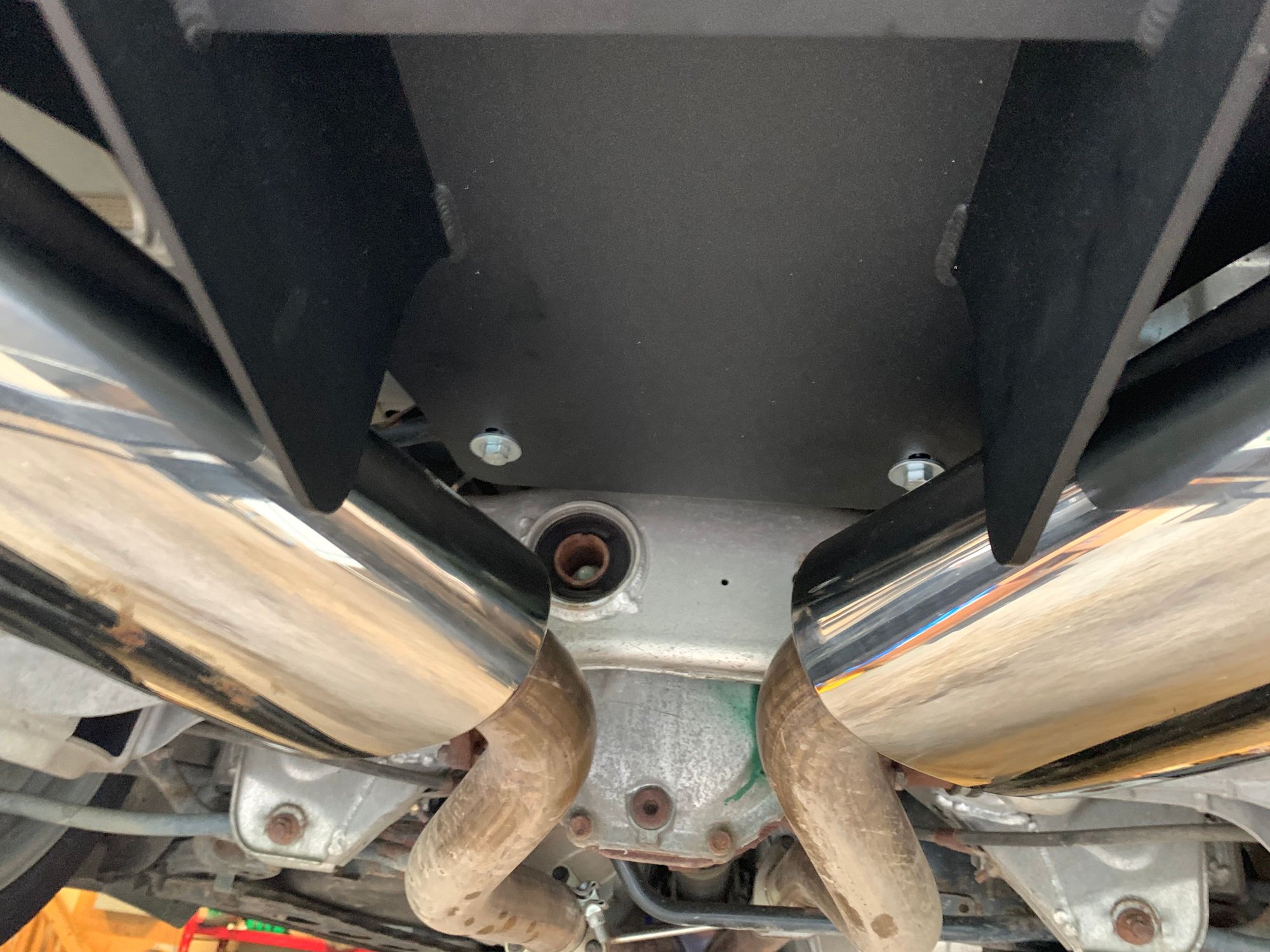

Black coated, showing front bolts to subframe brace right behind the diff:

The wing has a small angle and is gently curved up to try to generate some down force. Will see next track day, but it's mostly for looks.

It would have to be a group of least 5 or more. By the time I had these laser cut, welded by a buddies friend, and powercoated (we did 2), it was around 500-600 each. Plus there would be shipping from the great white north as these are bulky.
If there's some interest I can post the drawings. I'd have to tweak some hole locations a bit, the cardboard template was a little out.
