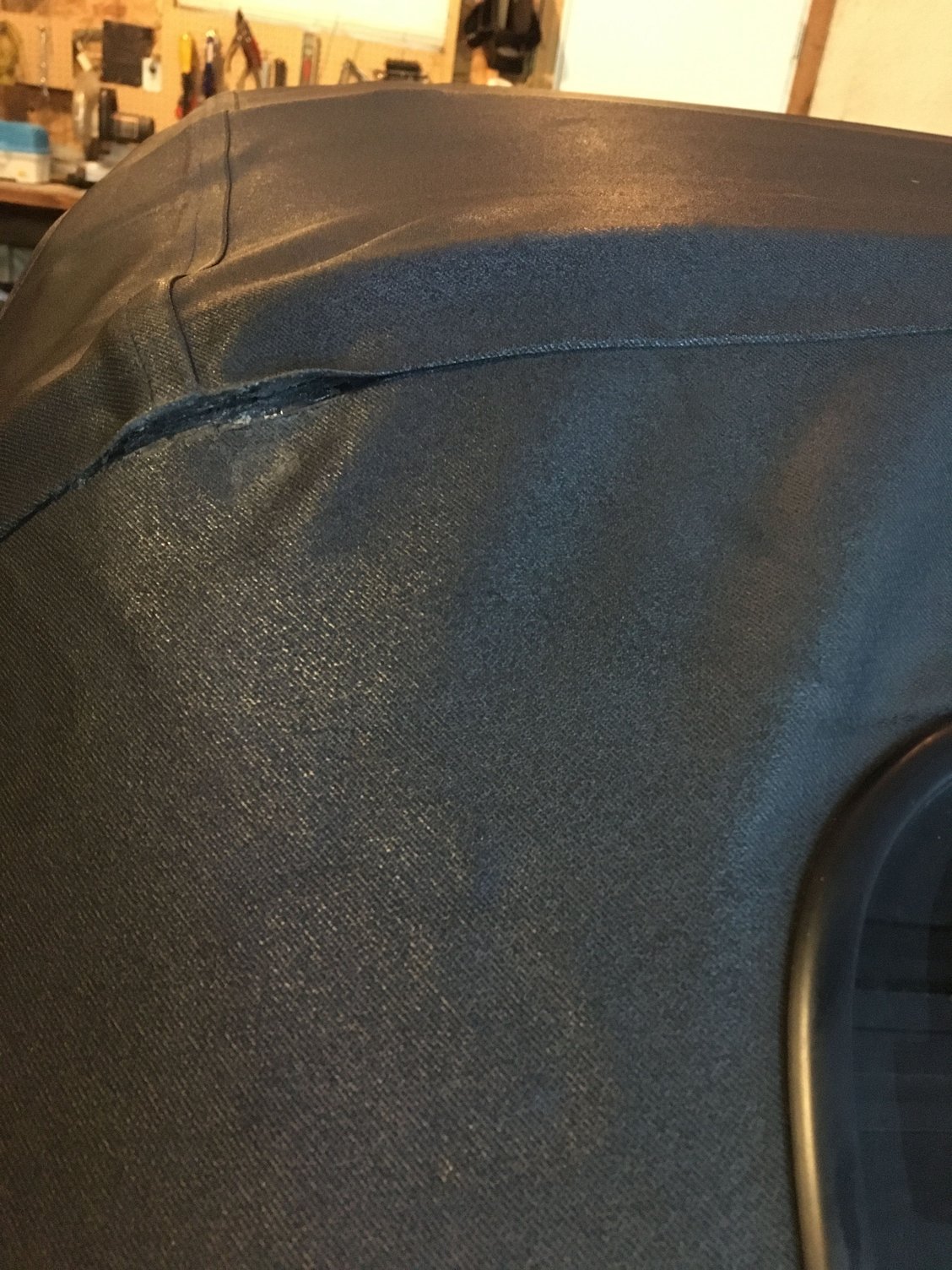

I thought about combining thread and silicone. I use the car as a daily driver with the top going up and down regularly hence the separation is spreading. Here are some pics.

Gotcha.
Clearly the adhesive has started to fail. Once a top starts to fail sewing and patching are really Band-Aid attempts to prevent further decay. I've seen everything from duct tape to silcone "repairs." IIRC the fishing line was from Bass Pro, black nylon braided 40# test, it did exactly what I needed before other tears appeared.
If it were mine, I'd sew it at least 2" past the problem area and hope for the best. You can get a nice replacement from Topsonline.com, Hartz Stayfast canvas (not vinyl) for my 06 was $650 delivered in 2013. Changing the top at home is very doable if you have the time. (8-10 hours). Gl!
